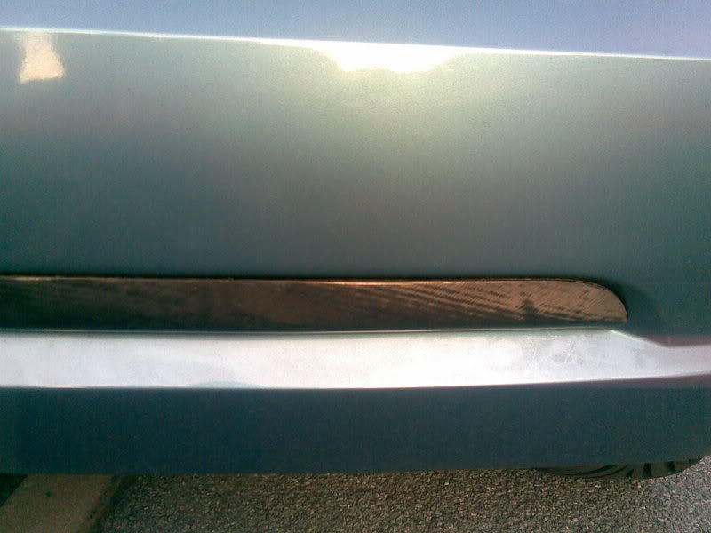

Yes it is, and its Middo's one which he made. actully it might be carbon fibre effect
  VW ....
i believe the one on that car is just the carbon fibre wrap .
had a look before myself for who does this with no success ,if u find out let me know .
Yeh I know he had this done too - makes it look for agressive I think although would need a different one for a 182.
  VRS
middos is proper carbon fibre which he applied ontop of the existing rear insert! ie it isnt a film cover, its the real deal!
cost him around 80 quid in materials iirc and looks the dogs, its on adams car now :D
Hows that work then Andy ??
  VRS
he bought the carbon fibre and the laquer/bonding stuff etc but because its too difficult to make a mould and fabricate a new insert he built up the carbon ontop of the existing insert iirc
mark will be able to give you all the technical talk but im too basic for that lol
all i know is that it took too much money, time and effort for him to do anymore lol
the imitation sheeting can just be cut to fit and stuck on as it has a sticky backing onit

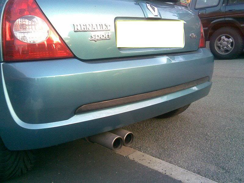

bit confused my eyes are showing the top pic having the bottom part of the rear bumper sticking out at an angle with nothing underneath it however the other pics don't show this. I wasn't talking about the black strip across the middle - is it just that pic or something?
  Chocolate Bar™
yeah its 100% real carbon fibre, so NO shitty sticky back crap on that.
was made from using real carbon fibre fabric, which was then resin'd onto the original black plastic strip. then resin'd until smooth, and then sanded and lacquered (around 20 coats) until it was smooth enough.
allll that and i ended up selling it for 40quid lol
Speak english boi .. ;)
