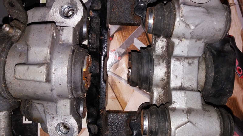

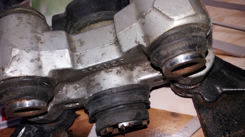

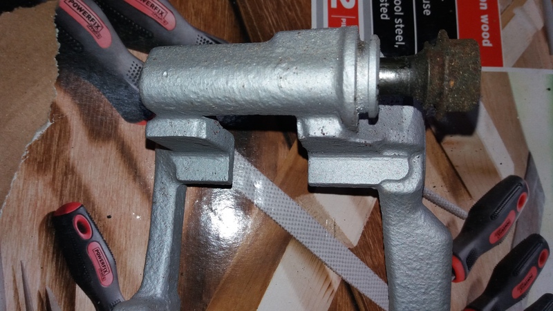

Can someone correct me if I'm wrong I wanted to remove the rear slide pins clean and re grease can someone tell me if Iv done the right bits as a bit confused

As far as I'm aware , the rear sliders don't actually have any grease inside them, I've never seen any, just a rubber gaitor on each end to keep the s**t out . They've got a polished surface if you look inside and the caliper being aluminium I guess they don't rust , unlike the front sliding pins that do rust if you don't keep them cleaned and greased.
2 pics of the rear and one of the front sliding pin.

You can use some grease on them, a smear of lithium or red rubber grease won't do any harm. None is better than the wrong stuff though.
