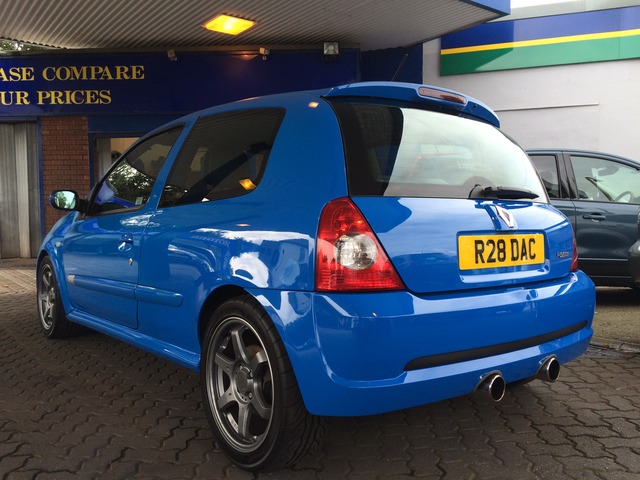

I've just tried the autosmart platinum and love it. Easy on and off but then my paint is pretty good so probably not what your after. Pic because I can lol

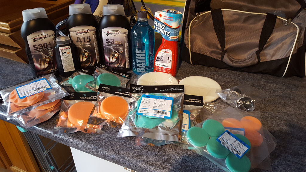

So i took Dave's recommendation and bought the Scholl concepts S3, well i got a bit carried away and bought this little lot. :blush:
20160922_133411 by Scott Raven, on Flickr

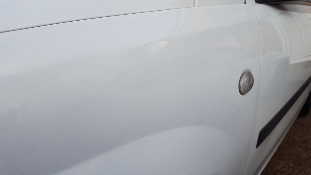

A flat white wing/door. Hard to photo. Its only an old van but it will soon be a shiny one. :up:
20160922_173255 by Scott Raven, on Flickr

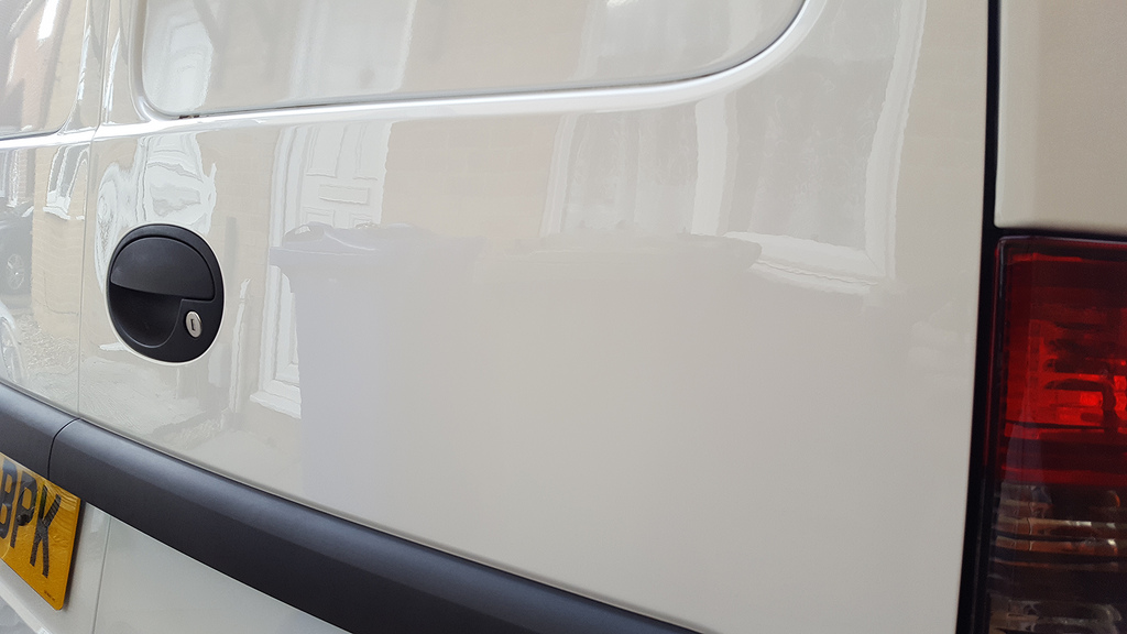

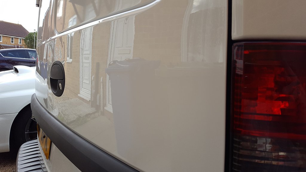

Rear doors polished just with the S3. :cool:
20160922_173219 by Scott Raven, on Flickr
20160922_173204 by Scott Raven, on Flickr
