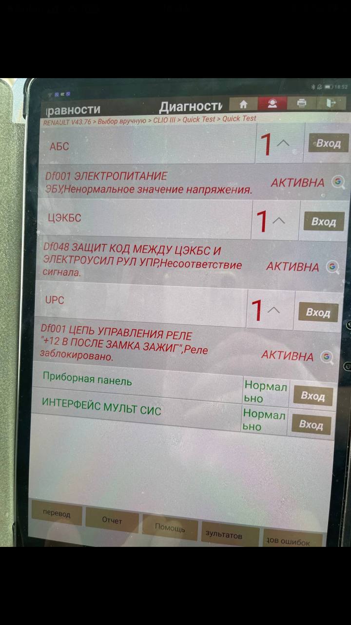

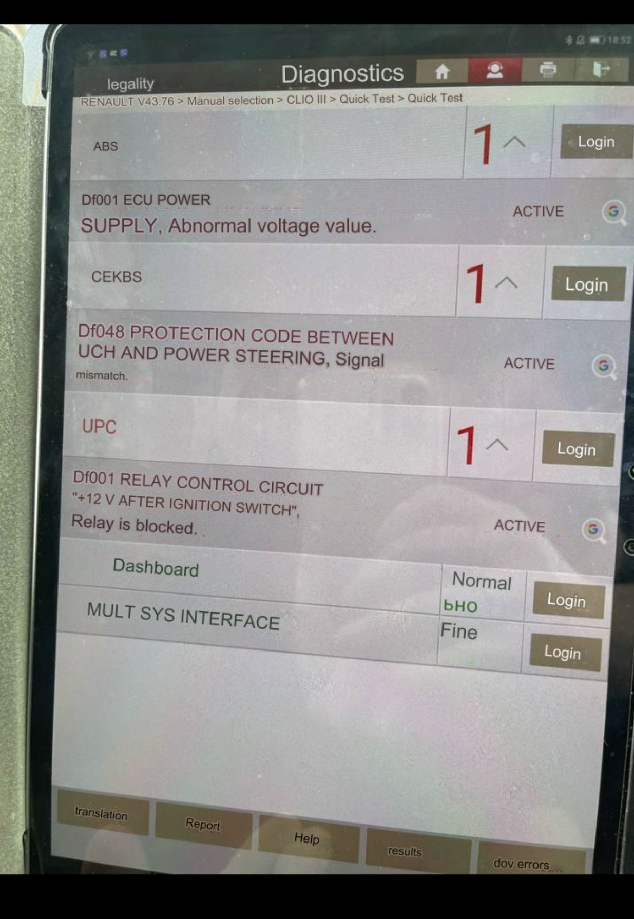

My car won't start when I turn the key in the ignition switch - at first it makes a sound similar to when the central lock is triggered, after that the "Steering Fault" error pops up. THE CAR WON'T START ((
I checked all the fuses in the car (in the car's interior and under the hood), they are all working. I took a new ignition switch for the car, connected it, but it still won't start (
I checked the starter relay, the main ignition relay, and so on, they are working. The steering fault error, as I understand it, depends on the last two errors in the photo (attached the photo below) 2)CEKBS-DF048. 3)UPC-DF001
1) I had the first error, its name is "Braking fault" it appears on the dial, on the computer it has the error code ABS-DF001.
so I drove for a year and everything was fine, only it was erased on the computer, and occasionally disappeared by itself, now it is not erased, and it appeared after they changed the clutch basket of the gearbox at the service (But the car started with this error!)
Now there is an error in addition to this "Steering fault" on the Internet means (failure of the power steering system) mine is electric.
Because of this error the car does not start.

Вибачте, я не можу більше допомогти, але пошук коду DF048 у Google придумав цю тему, https://mhhauto.com/Thread-Renault-Clio-III-DF048-EPS , схоже, вони замінили гідропідсилювач керма модуль.
Дякую, брате(у)
Спробую обміняти апарат на б/у.
тому вони змінили лише модуль?
