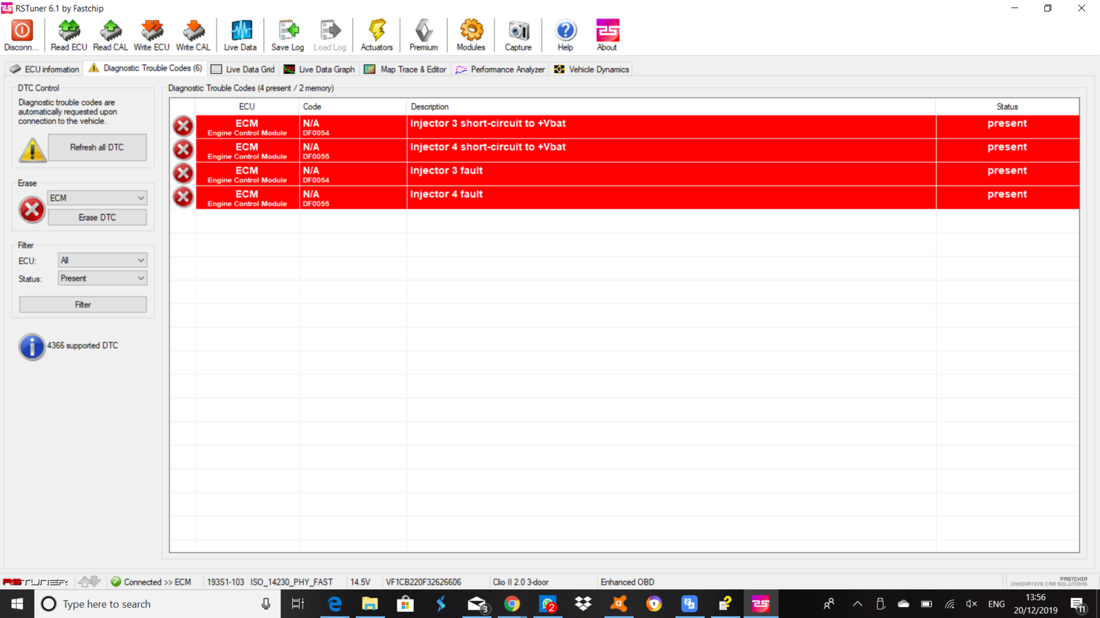

Hi all,
just plugged my RS-Tuner in and it's thrown the faults below up.
it says short circuit, does that mean fault going to the injector or it is the injector it is screwed or potentially both?
the car is running like its blown an injector but the other week when this started i went under the glove box cleaned out some connections and it ran fine for about 15 miles but resorted back to its old games again.

It is 4-3-2-1 as you look at them from the front.
So it's the left two you want to swap with the right two.
