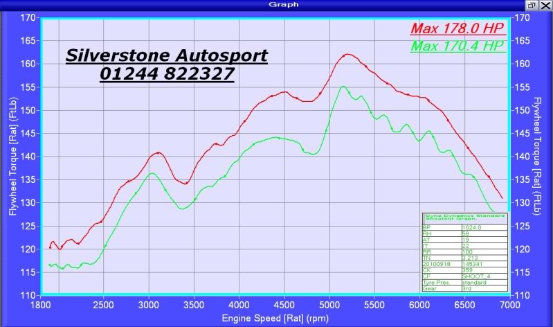

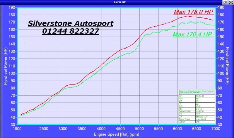

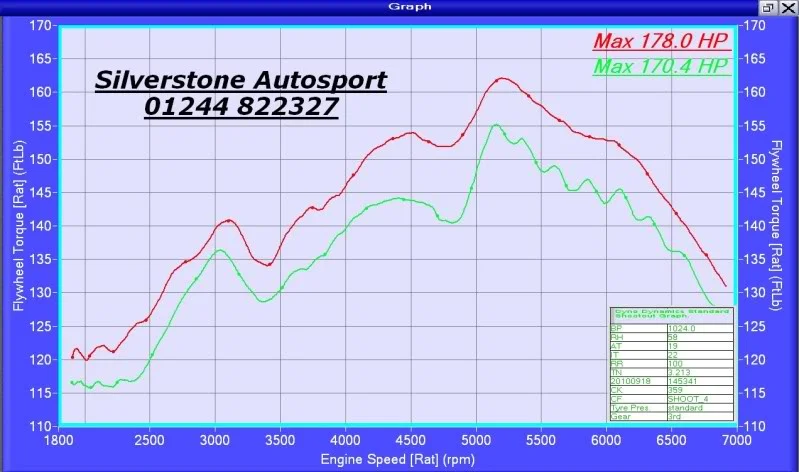

So heres the RR results.
(I know the runs were on different dates, but the last time I was there it seemed to show consistency, being accurate for different figures of different cars)..

much smoother power curve too. looks good results to be honest. i would be happy.
i think people are getting confused besause they are not reading the graphs, they are just looking at the 'max hp' on the top right of both graphs

Pretty good going from an exhaust, I made an additional 4bhp in the end from switching from the mk1 stealth system to 2.5

I would be happy too, nice smooth curve, and good torque, we should all know about claimed bhp/ps figures lol

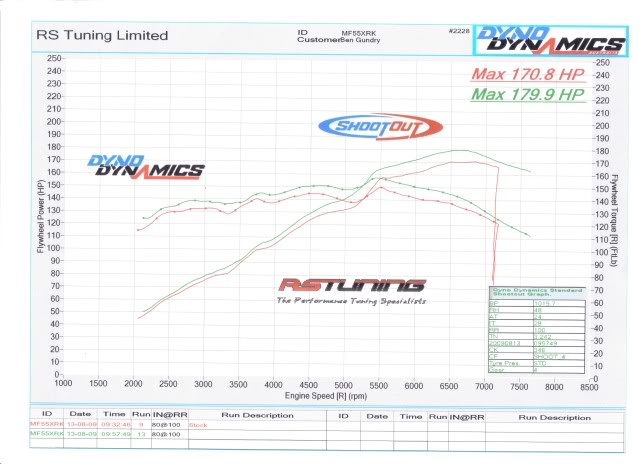

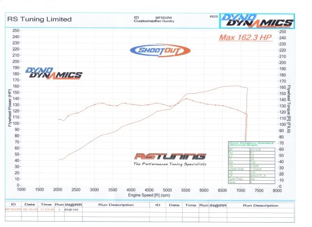

I had my Trophy put on the RR at RS Tuning. The car was standard and made 162.3 BHP and 140 Ft/Lb (at the Fly).
I then fitted the Scorpion RS192 full system and an ITG Maxogen. I went for a remap and here were the before and after results..
If you compare the results between the standard car and the run before the remap there is a difference of 8.5bhp and 10ft/lb. As a rough estimate I thought that was a good increase for an exhaust and air filter.
