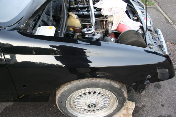

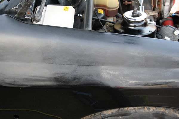

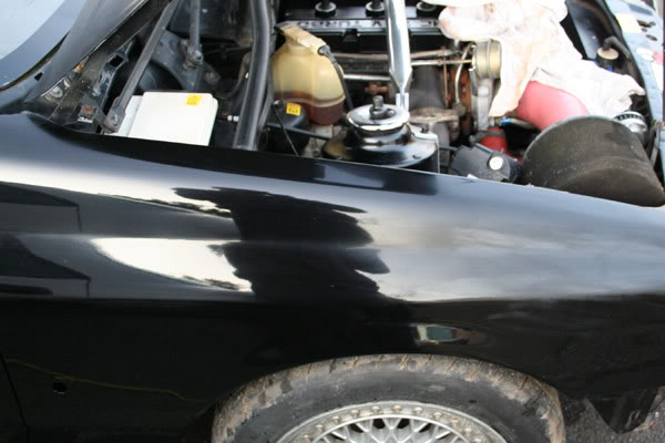

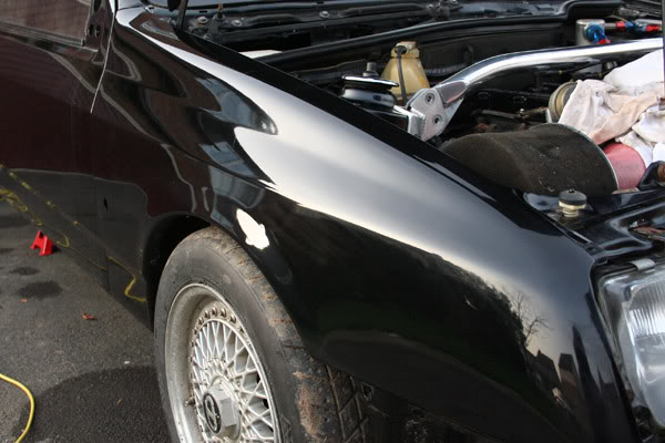

i have got them both the 2.5 and the 83 but i can still see the marks i am using them on a sfx yellow pad and used 2500 wet and dry paper

That's odd, tried them on 4 inch spot pads?
What Paint is this on? I would use Intensive Polish myself then step up to Menzerna Powergloss if it really needed it.
Multiple passes if need be of SSR 2.5 on a 4 inch cutting pad should work fine though.

You will need pressure yes. PC wont do much paint correction at all without pressure.
