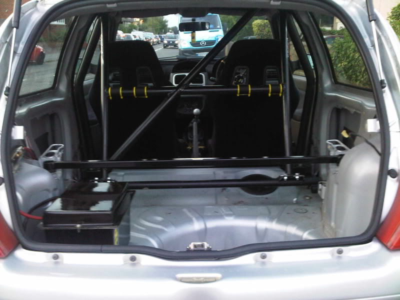

hey people im just after some advice realy, how/ or whats the best way to secure my harnesses to the cage, its probably dificult to describe so picturres would be best

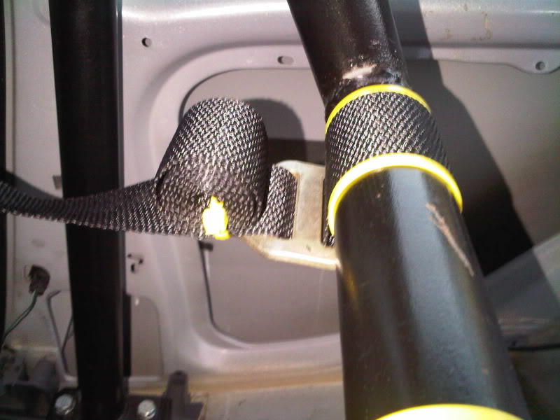

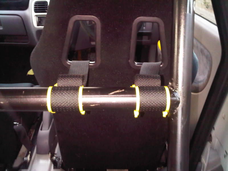

sorry yes i mean this how do i actually tie it on / secure it

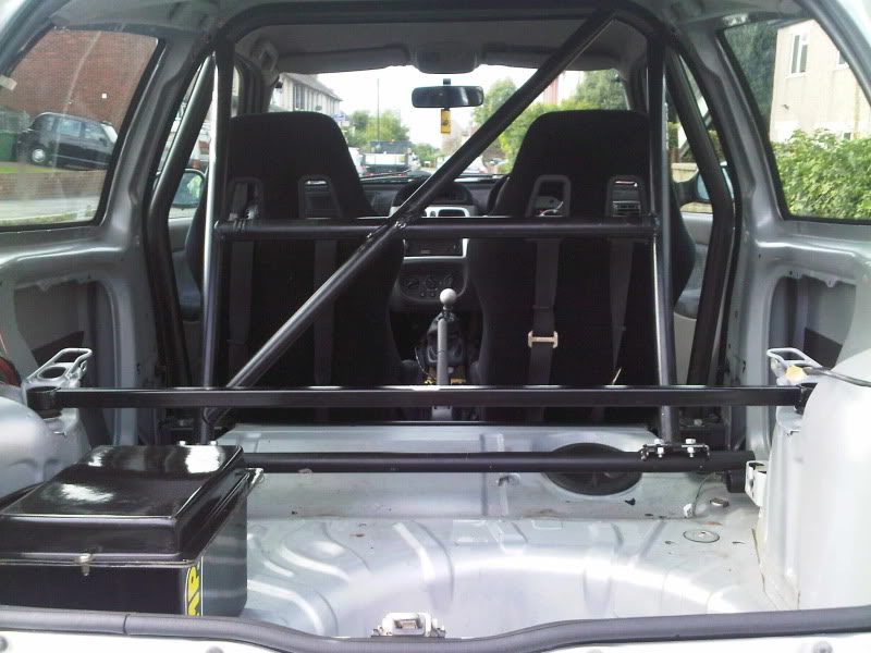

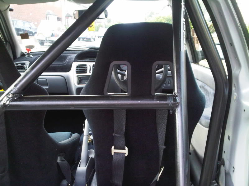

heres some pics

anybody else? i need this done tonight as im off out in the car soon iv looked at a couple of pics and have tried how they look but they dont seem to lock tight ?

yes they go through the gold bit > arount the bar > then back through the gold bit > then roled and tied?
