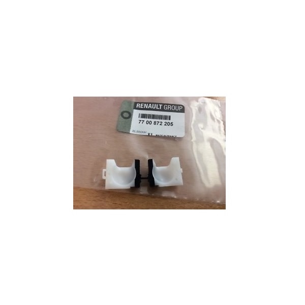

I've also read that there's a plastic bush in the shifter somewhere, is that something I can replace easily without changing my nice snappy gear knob to rule it out?

New nylon bush and circlip is in, old one was definitely at the end of it's life and the gear shift feels marginally better (wasn't bad to begin with), but unfortunately the rattle is still there. My mechanic is convinced it's on the inside of the car, or at least not on the gearbox end of the linkage.

There's not loads to rattle tbh. Is the reverse cable fitted properly/twisted?
