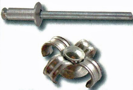

Use peel rivets instead if the usual type, otherwise they might crack the plastic or pull through.
They look like this
