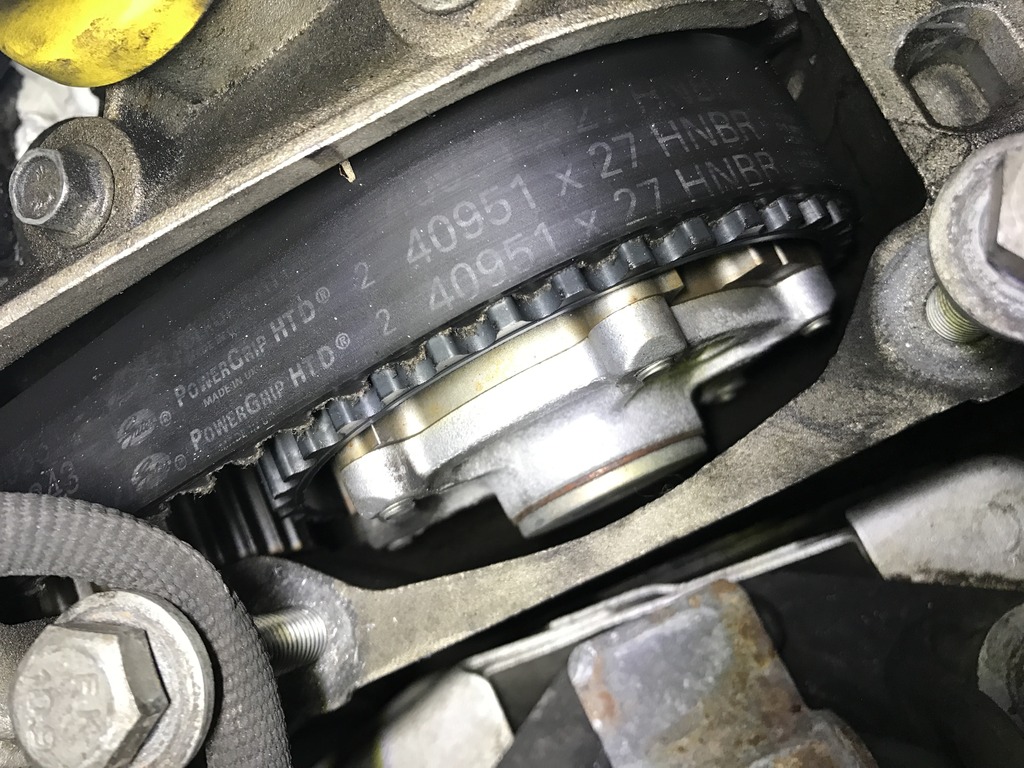

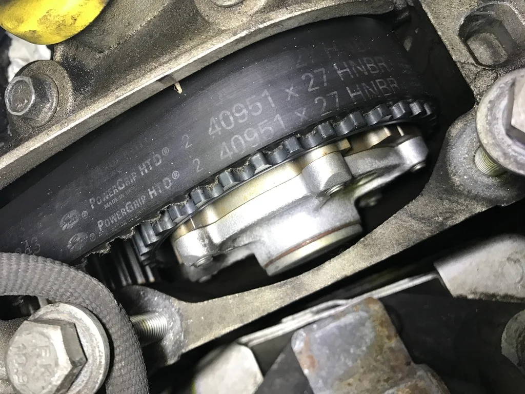

Engine mount off to inspect the belt:
All in one piece, so I guess its just jumped.

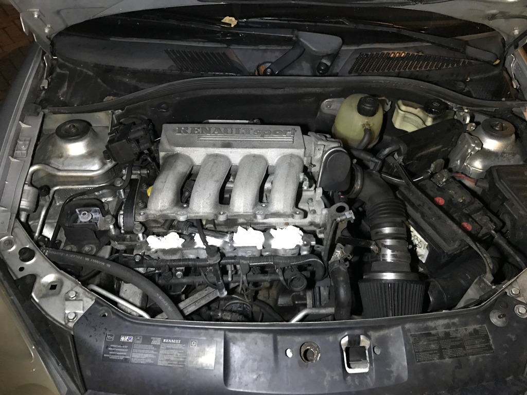

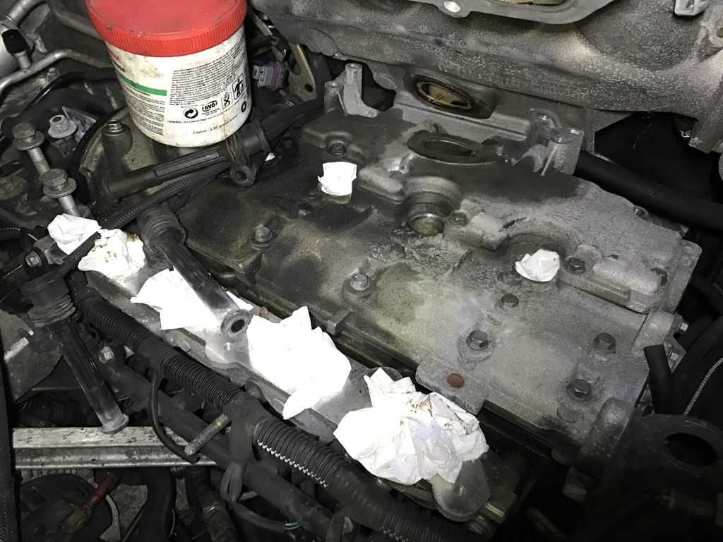

Inlet manifold lifted to inspect spark plugs:
1, 2 and 4 came out no problem and looked fine, however 3 wont move. Guessing its pretty messy in that cylinder and has caught the plug hence it not unscrewing. I'll take the head off anyway to see, but i'll probably go down the new engine route. The spark plugs were replaced last year according to receipts and they do look pretty new, so there isn't really a reason why it shouldn't come out.
