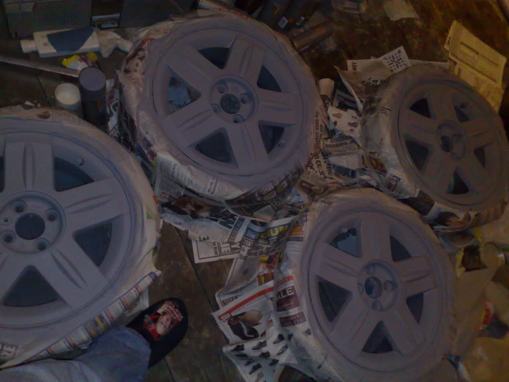

Not impressive no, but you can see whats going on here ;)

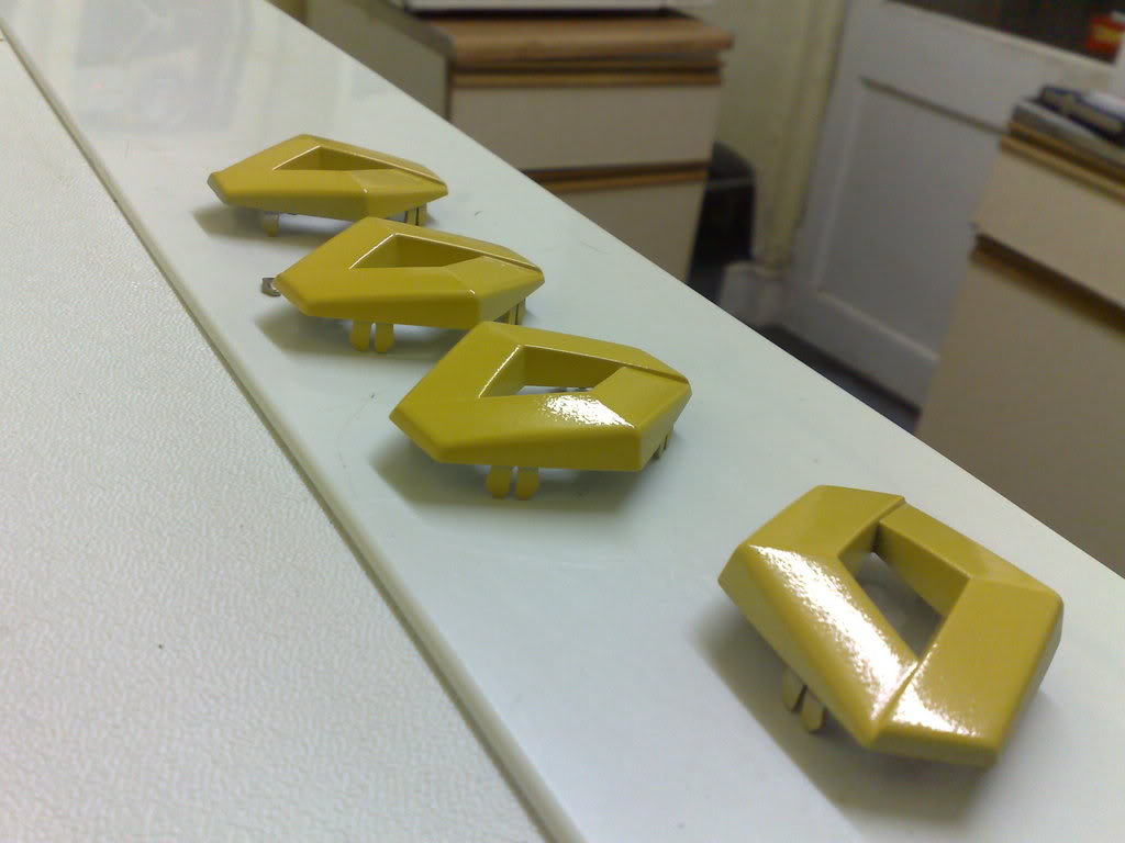

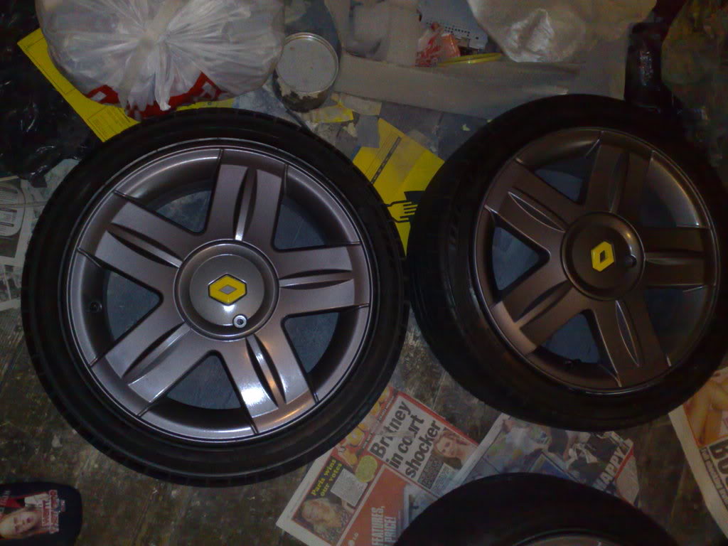

ill appologise now, but your paint job on the diamonds is shoite!
I totally agree with you. Its one of those ones when you look at it after and go "oh..f**king b****cks.." Im going to re-do them again, it doesnt take long anyway. thanks for the comments so far.

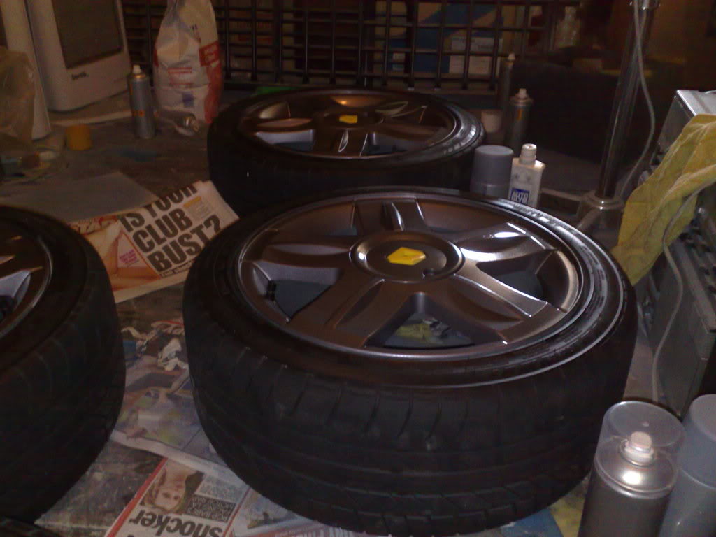

But anyway, moving on, these were finished yesterday, im going to mask it again and spray the lip tonight ;) Sorry for the s**t quality, a dark room and N95 camera doesnt seem to mix
Heres the pics so far;
Im going to get these put on next week, i will update the thread once theyre on.

Cheers, i just wanted you guys suggestion here. Should i do the lip yellow or leave it as it is??

the wheels look good compared to the orange peel on the diamonds. they just need a little wet flat and just spray a little less next time and it wont run.:) lots of thin coats and they will come up perfect

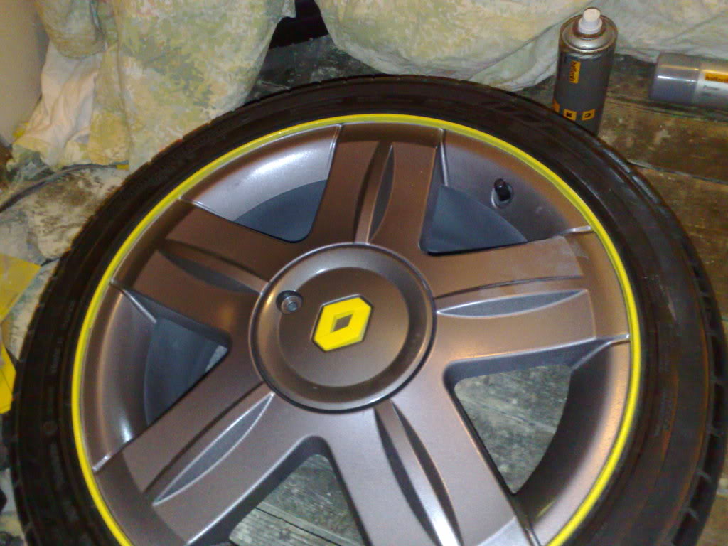

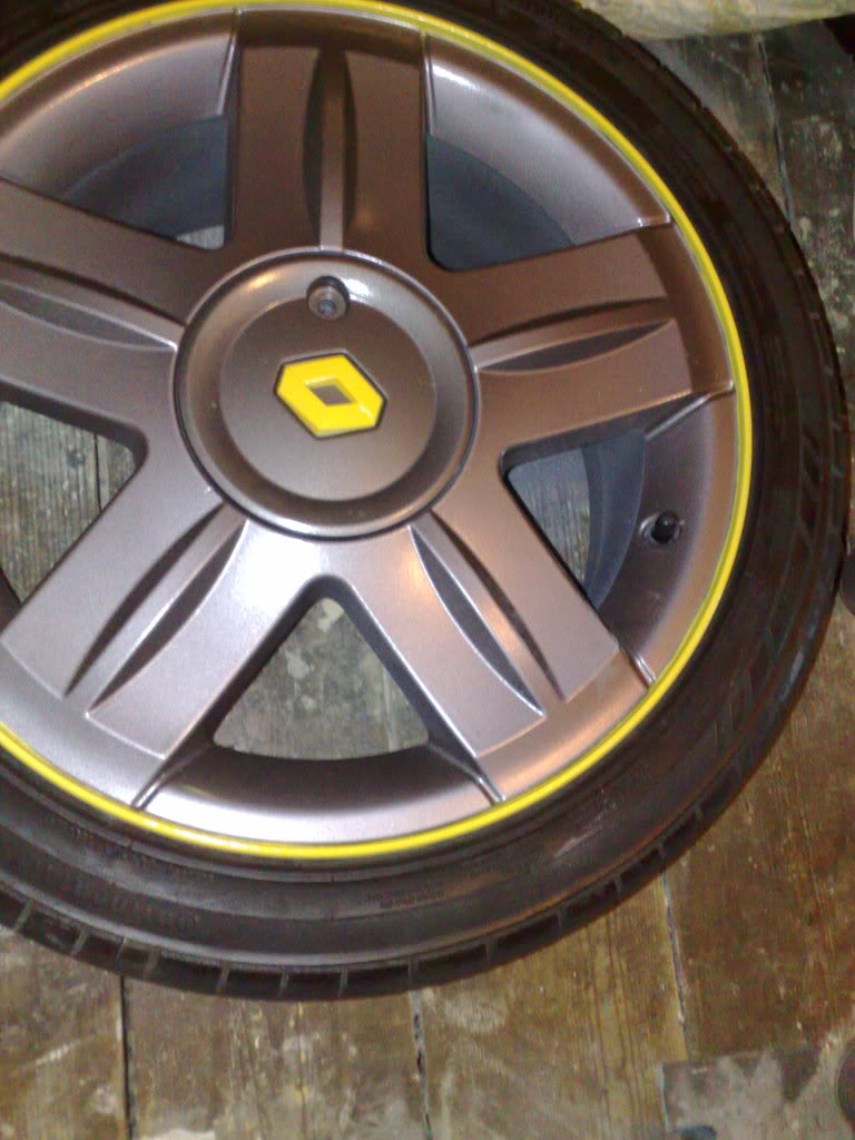

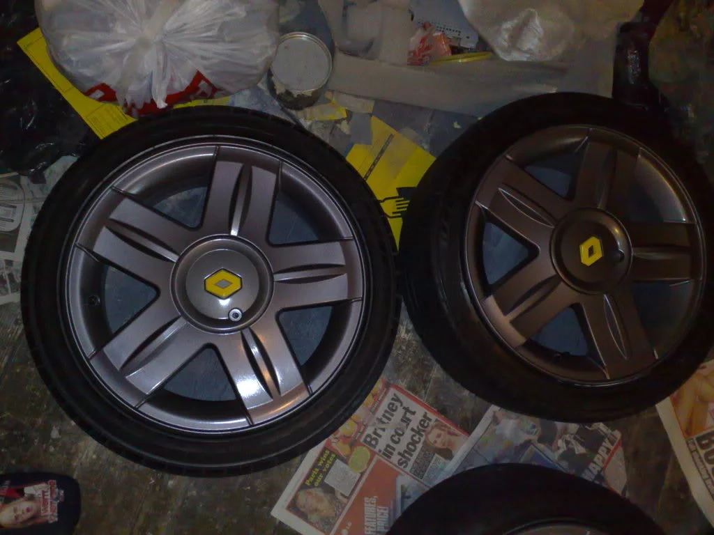

Done the lip, on one of them.. just ran out of bloody paint
I've tidy d up the lip now by scratching the excess paint off very lightly, now looks mint
  LY R26
i think it looks too much with both done, either the lip or the badges yellow will look gd, may look better on the car tho.
