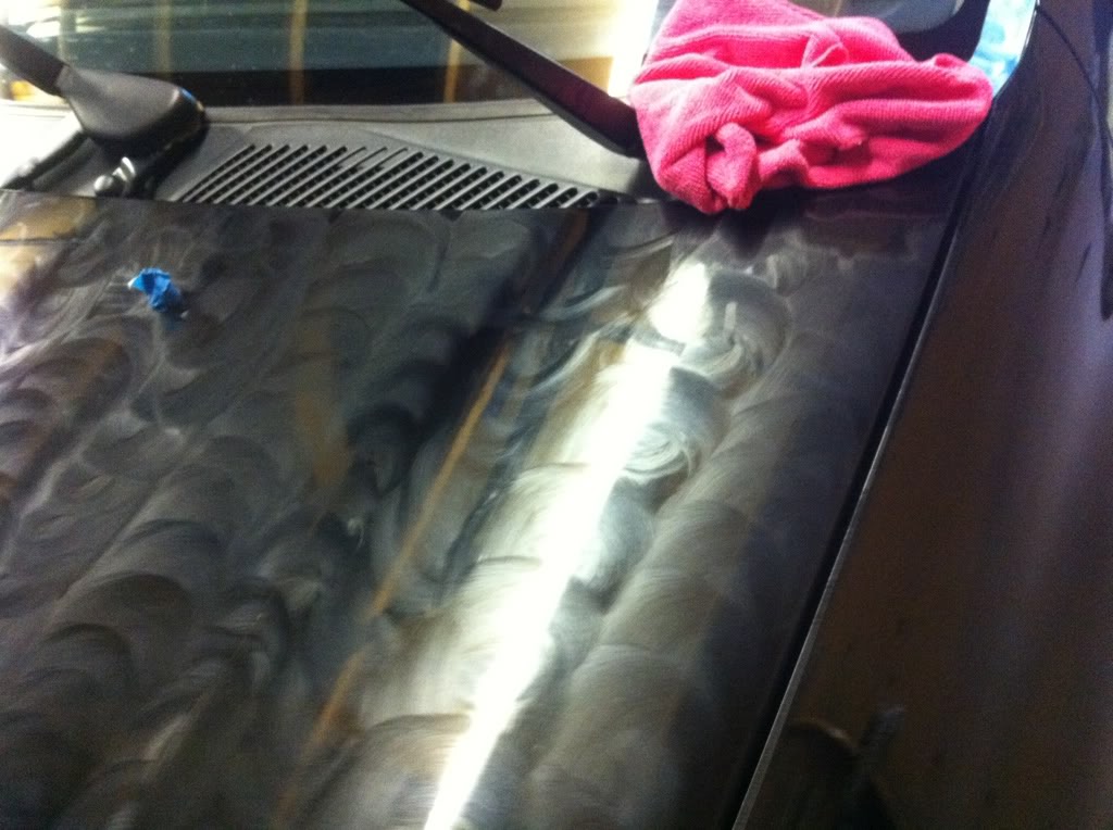

I chose to use Sonus SFX-2 on a Sonus number 2 (white) pad with the DAS-6. I didn't have much means to see the swirls really in the garage, and the strip light was just showing up all the RDS that her cat leaves. So I took a punt on that combo, hoping it would be good. It's given about an 80% correction swirl wise, so not bad for a random stab at a combo lol.

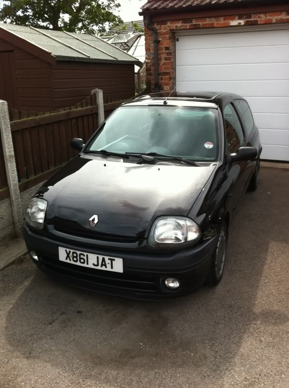

Finished result...
Not bad for 9-10hours work, will definitely help it sell.

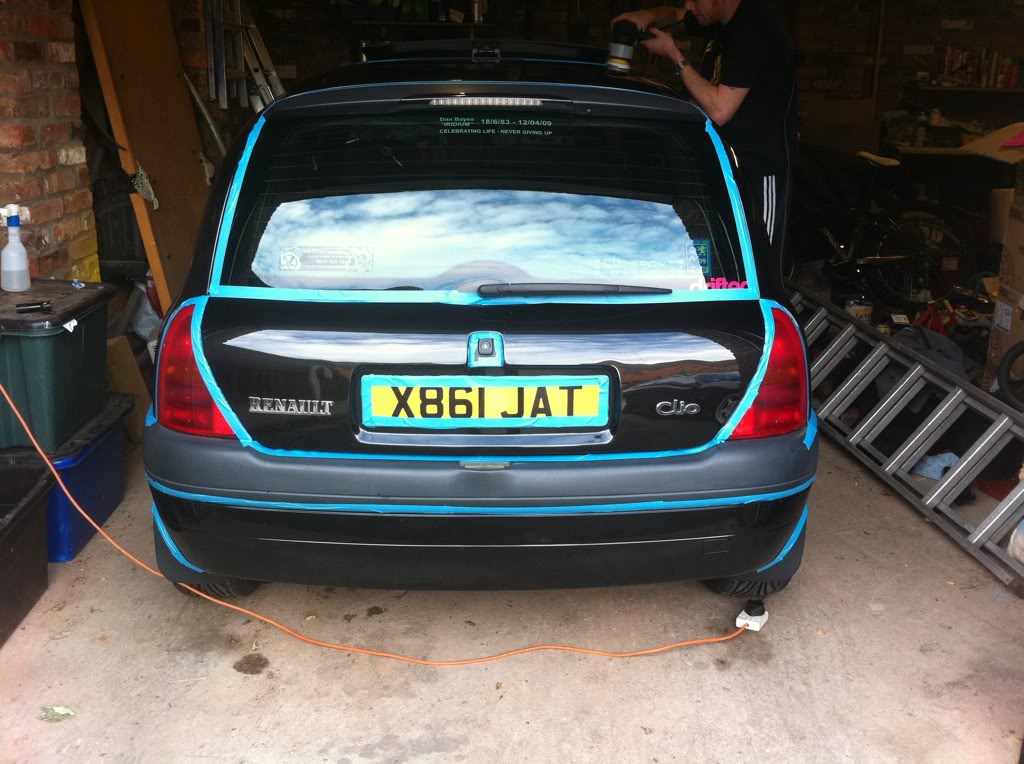

- Taped up

Finished result...
