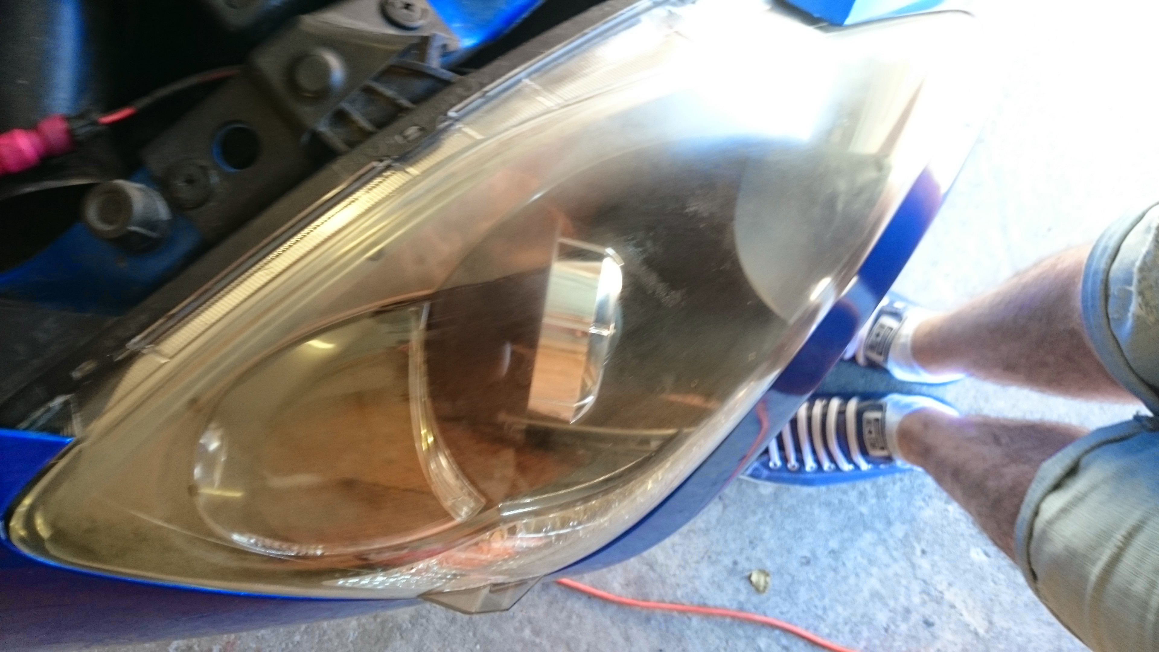

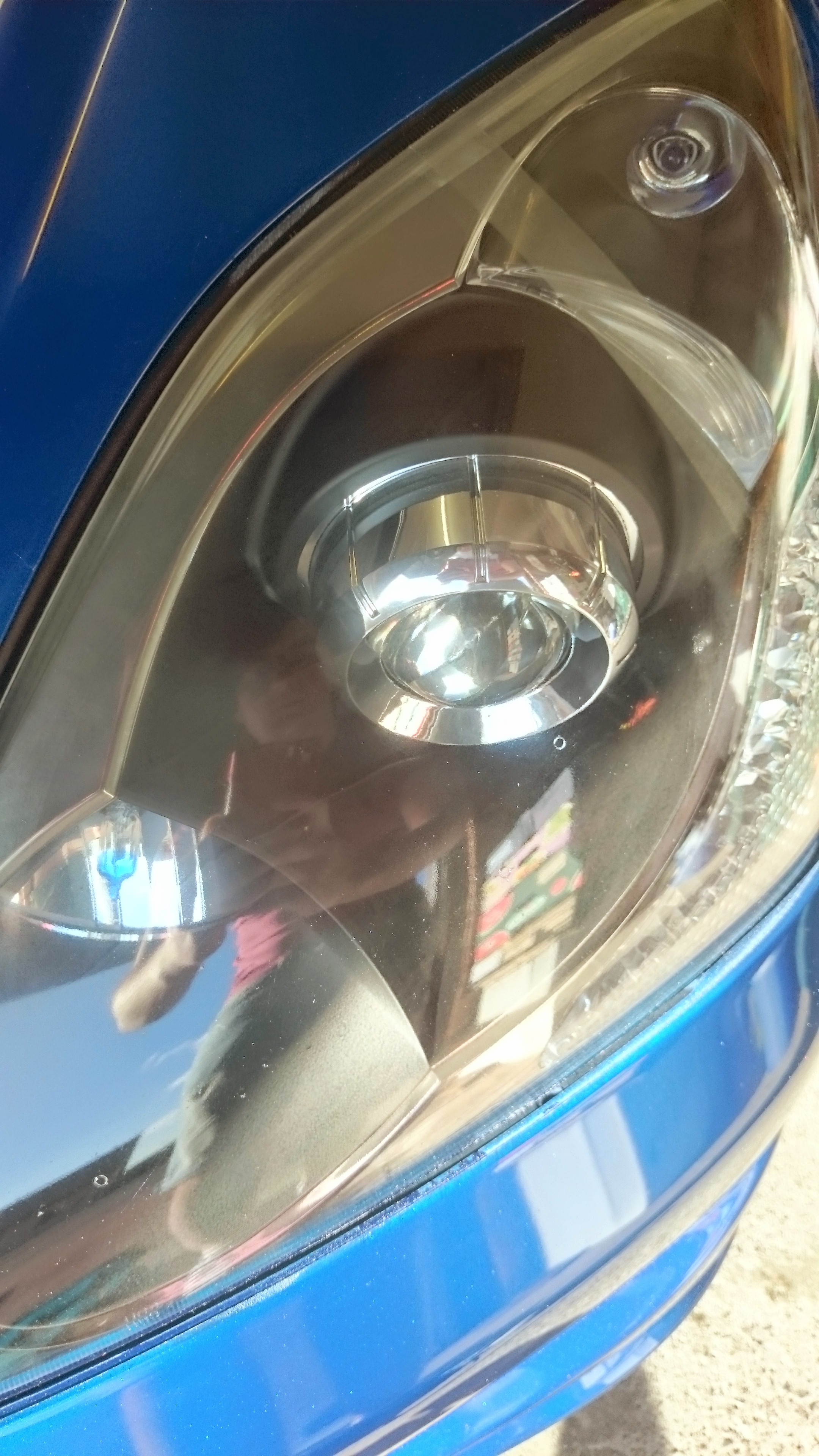

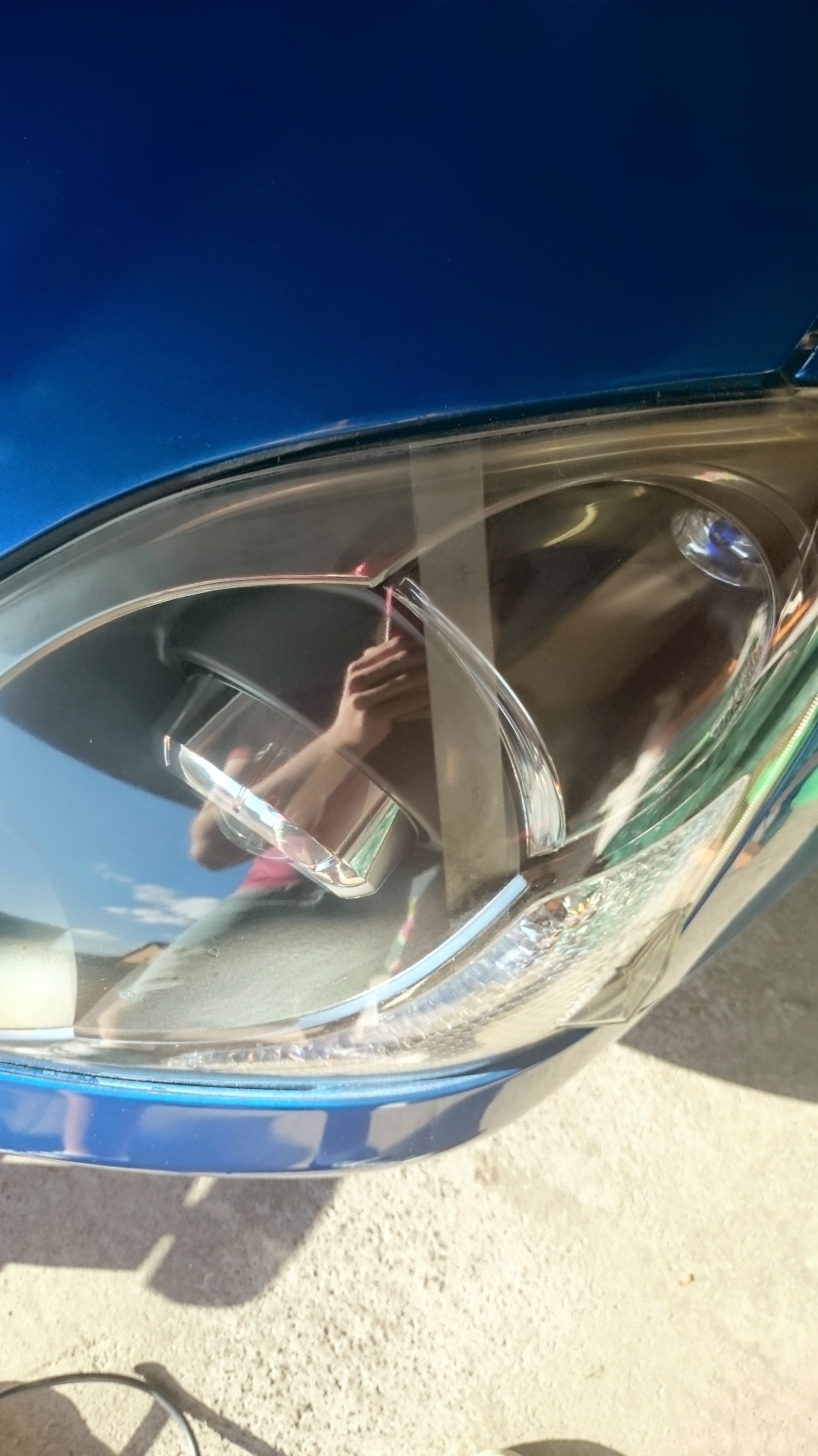

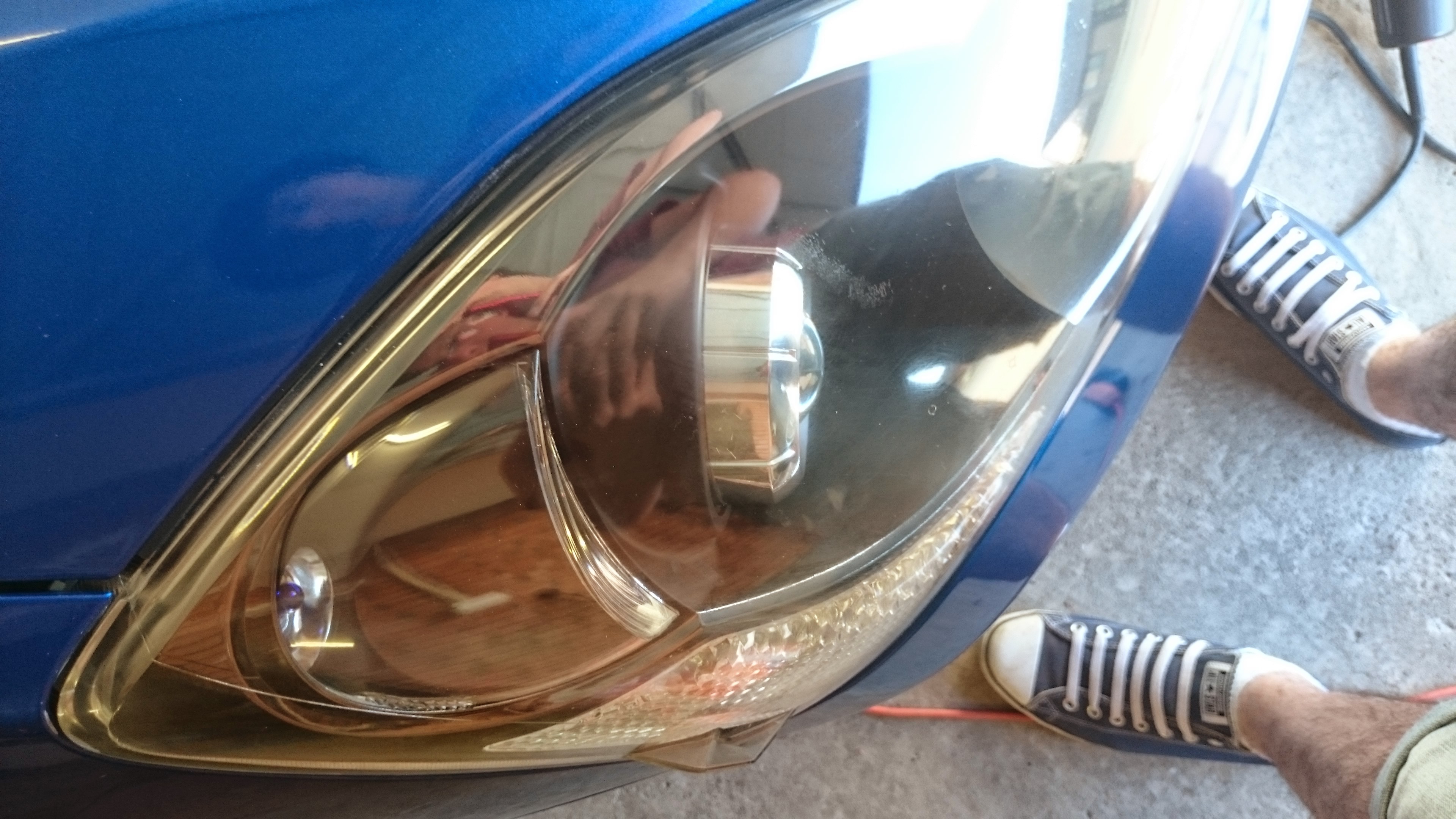

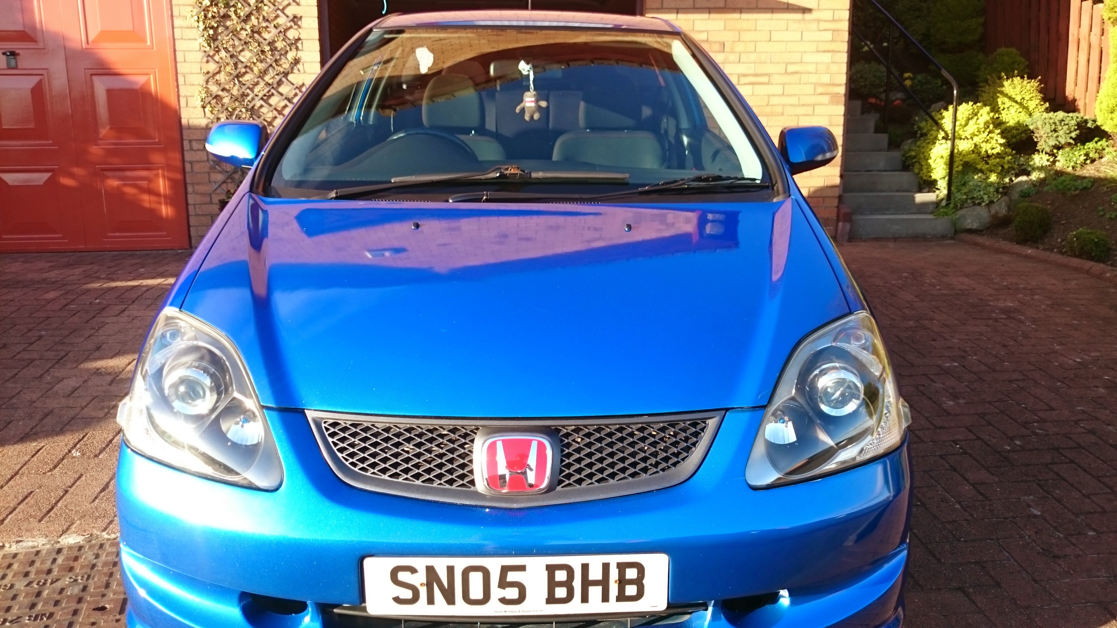

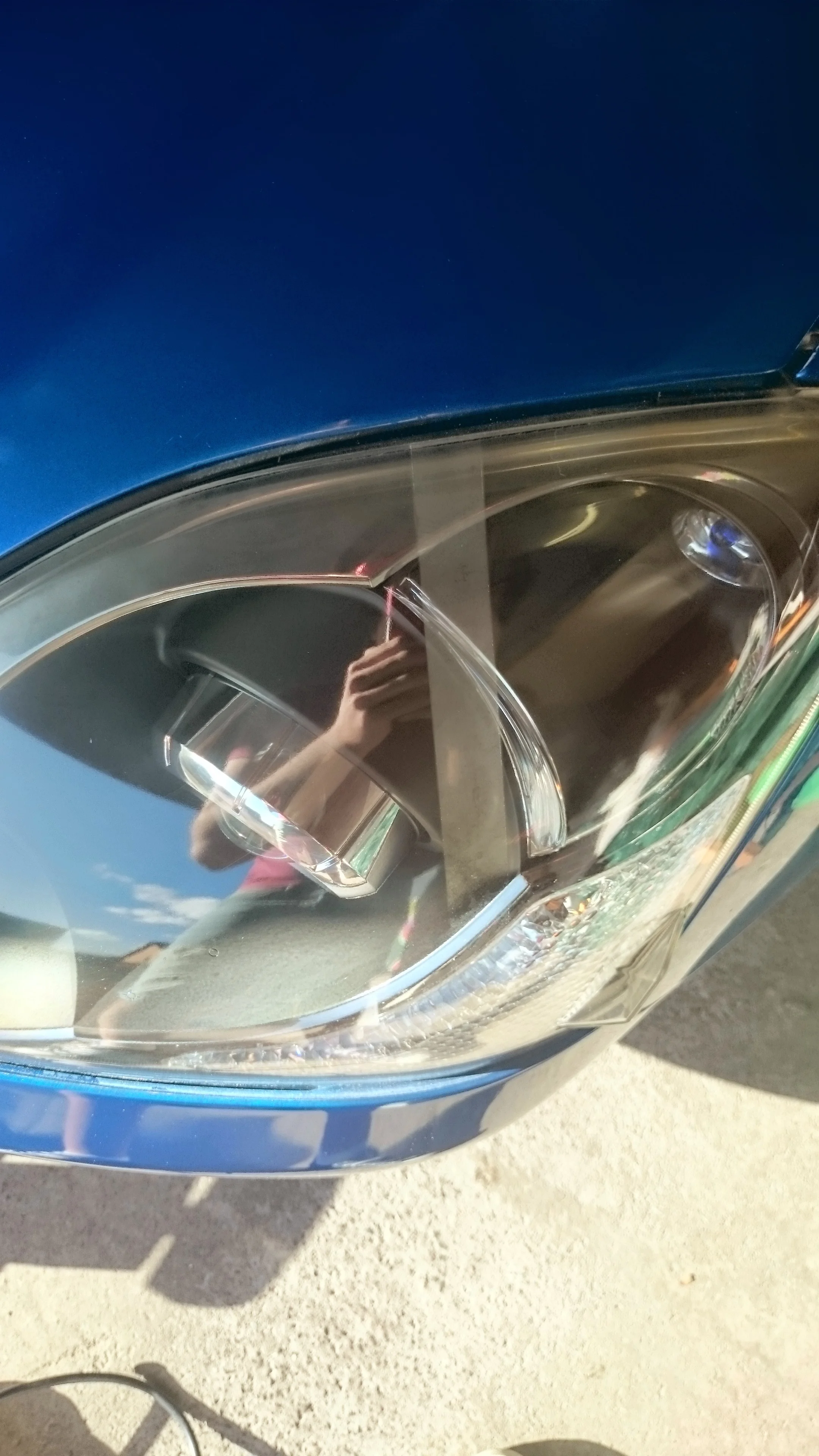

thought id share my recent experience, my pal brought his (my old) vivid blue ep2 civic sport round for a bit of a waxing session so i thought id take a bash at his headlights because they were disgusting, less than 5 minutes with poorboys mastercut on an orange pad with my da and they look excellent, such a difference.

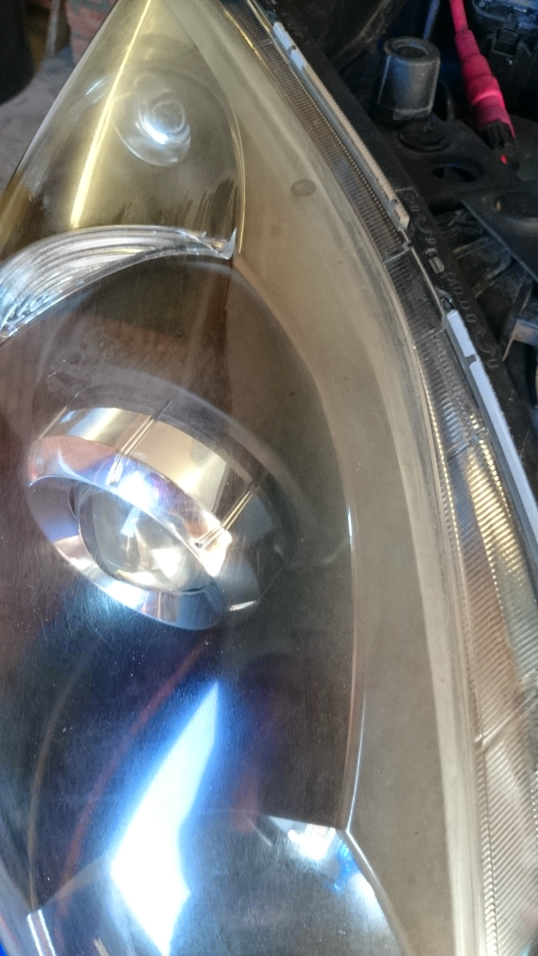

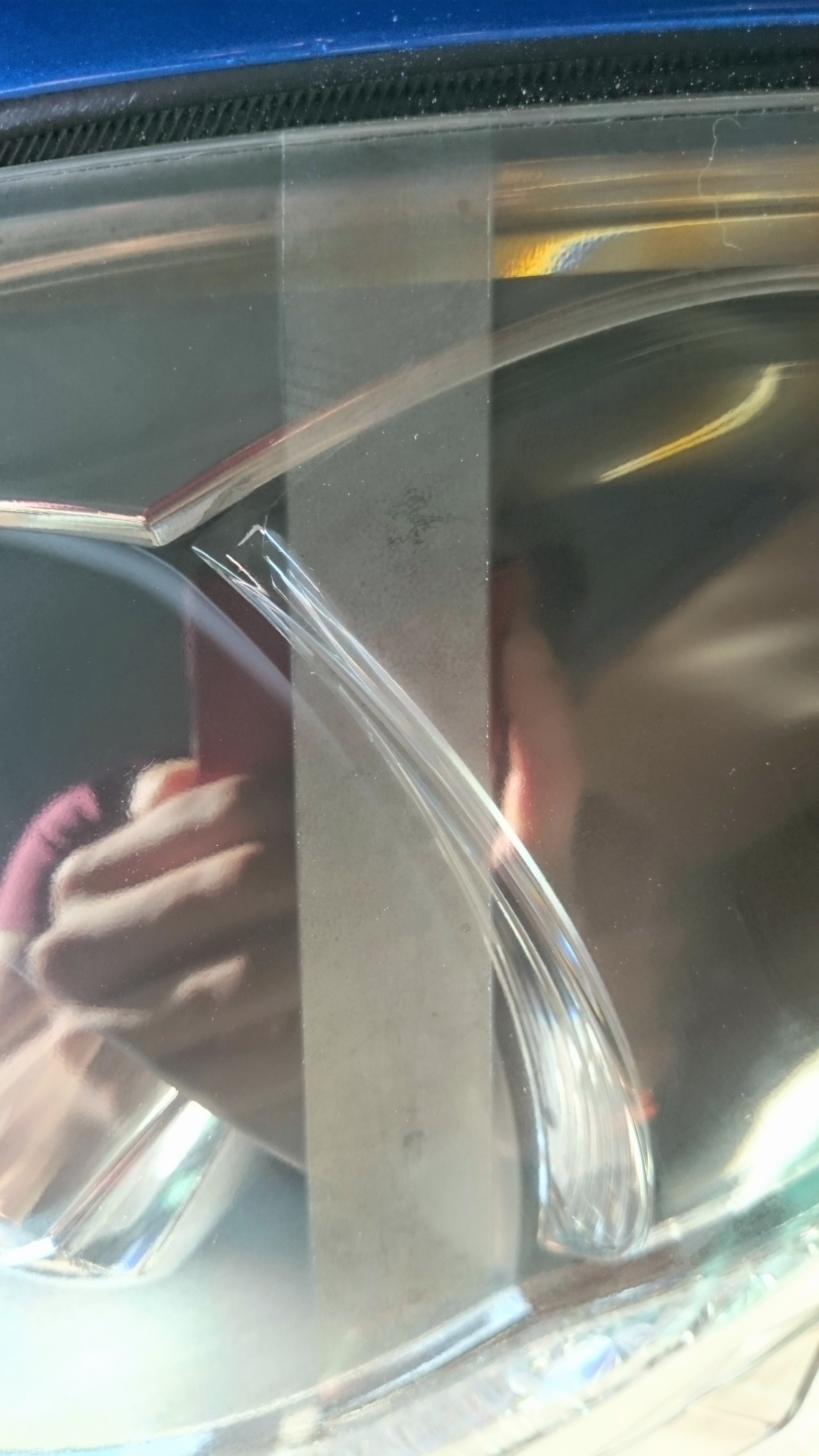

i'm really annoyed i never took a picture of the passenger side light before i started as the tape shows what kind of condition it was in!
quite impressed with the results as it finished off the car looking clean!, it needed some love after a 1 on 1 session with a deer
anyway, piccies.
pic daft. anyway, i've had some decent results doing lights as parts of details before but this was the most satisfying because it took 1 or 2 passes per light

The lights would've been even better if I spent some actual time on them but they've turned out very well for the minimal effort
