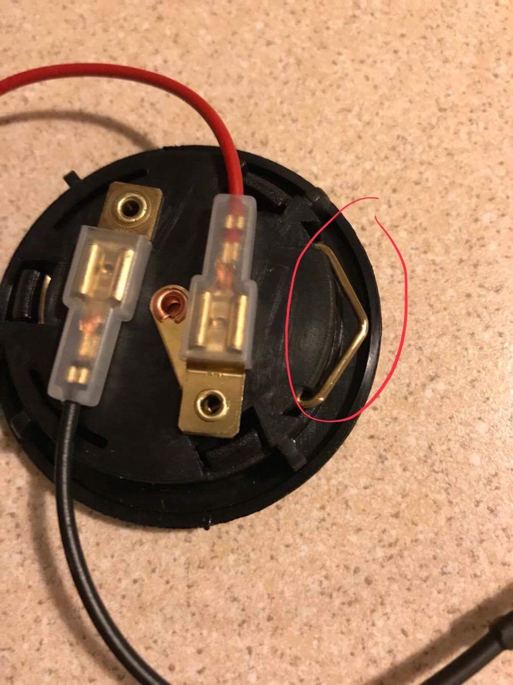

On my OMP wheel, I cut off part of the spring clip just as you suggested, it ensures it doesn’t short to the wheel. I even insulated parts of the spring on the inside of the horn mechanism where I thought there could’ve been a further risk of shorting (overkill for sure 🙈, but the OMP one has some metal rivets inside to cause me extra anxiety 😅).
It’s the bit sticking out in the pic that touches and shorts on the wheel....
But, and it is a big but, you do risk NOT looking cool waving to your people :smile:!

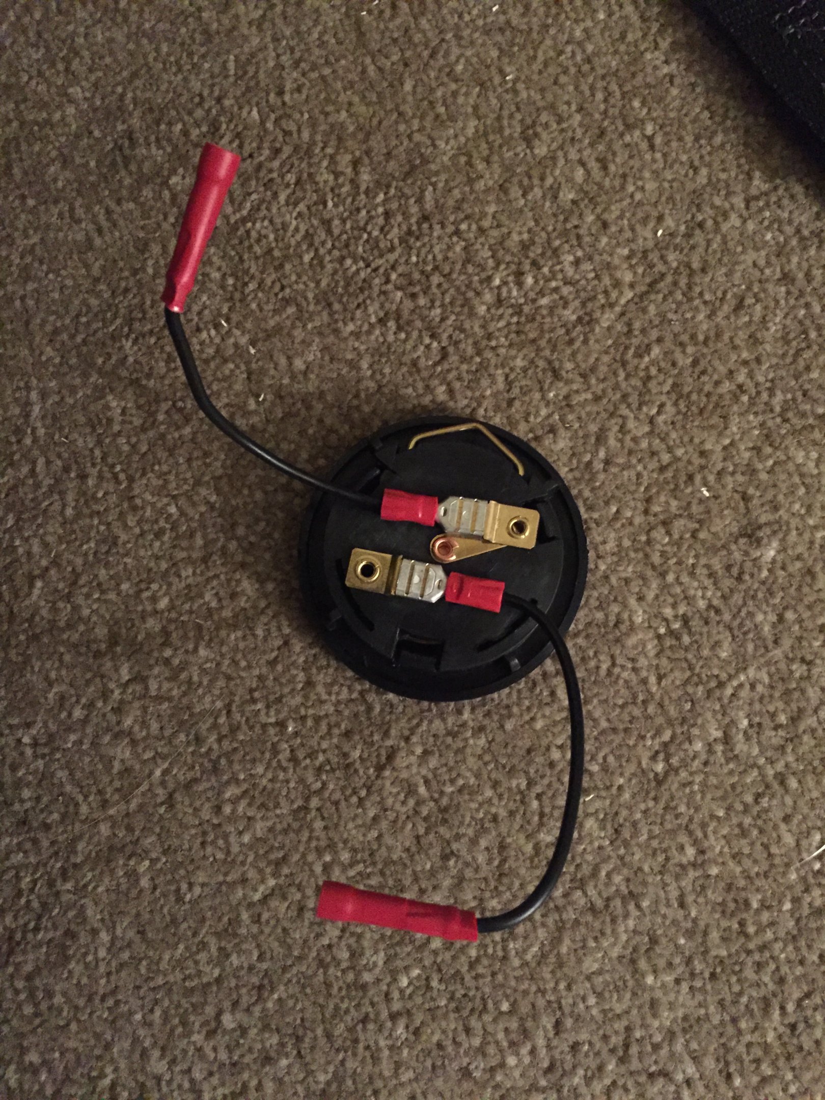

Thanks for the pictures mate. The sparco one looks identical. I pulled out that spring clip and cut it short then slid it back inside. Was going to pull it all out completely but decided against it as not sure whether it's connected internally...
Not tried it yet but see no reason why it would short.

As long as the spring can’t touch the wheel then there’s no chance of it shorting, it’s why I put insulating tape at the bottom of my button, belt and braces and all that! If you’re really worried you could wrap tape around the spring windings itself :smirk:. I presume the Sparco horn has the two spade connections?
  BMW M135i; Clio 172
And as long as it can’t touch either of the spade connector contacts! Although that’ll probably just make the horn beep constantly :confused::smile:.
