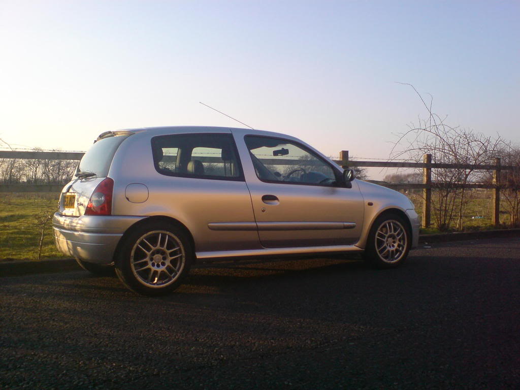

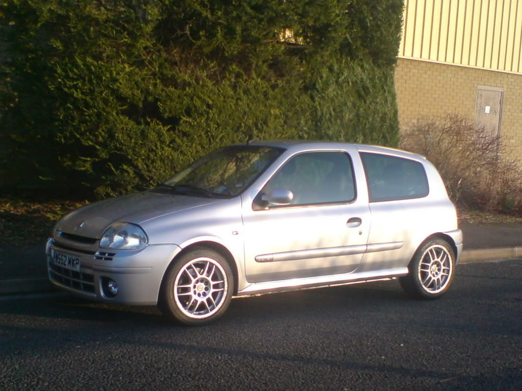

To prove the wheels fit ok here they are on my car, note I've already got the rings fitted cos I've got them for my leggies.

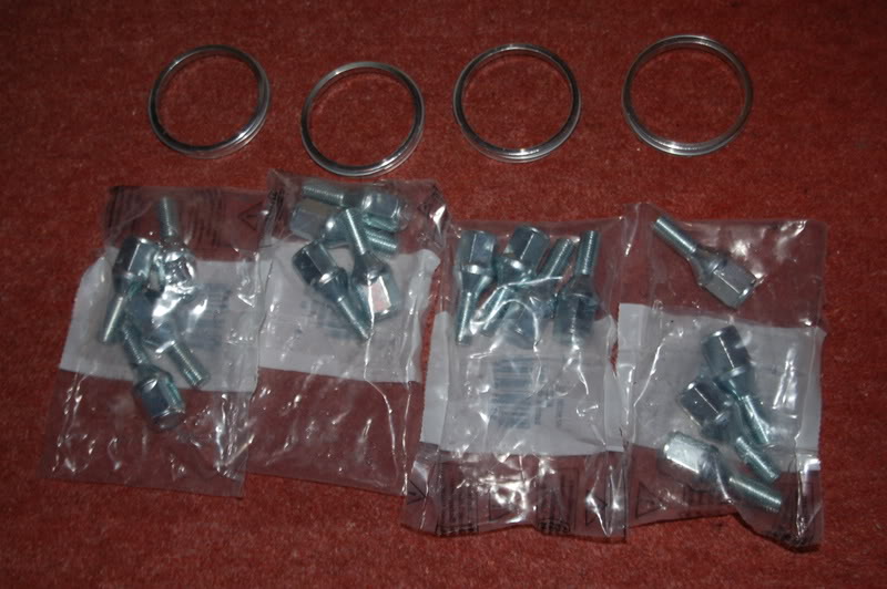

you can buy an oz wheel fitting kit for £25 quid from ripspeed (they'll have to order it from motosport wheels) comes with 16new shiney wheel bolts and 4 renault spigot rings
