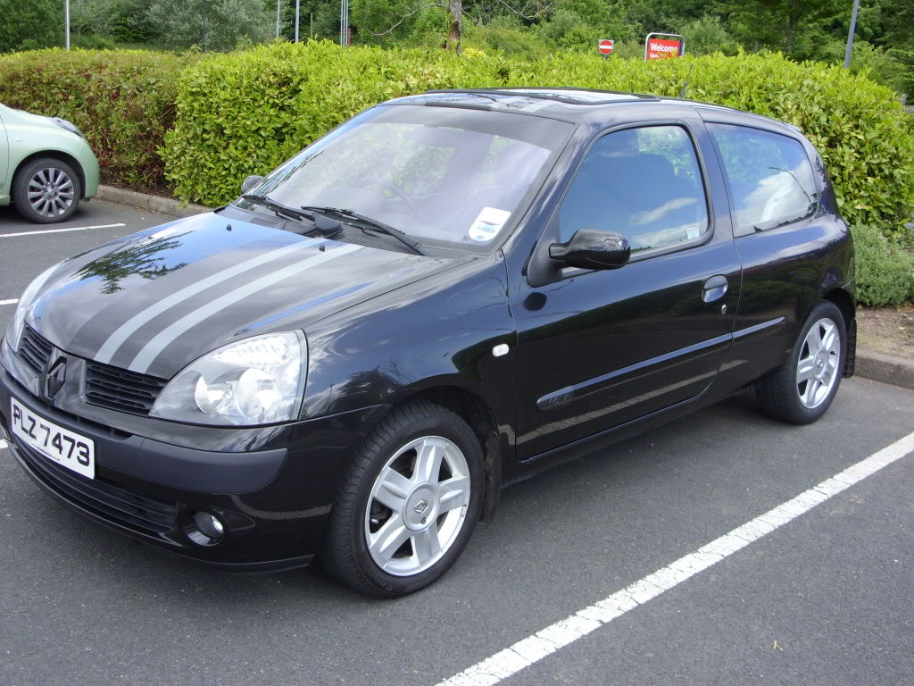

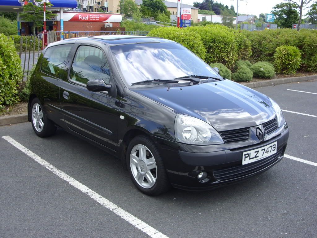

Just did my badges, bullets and bump strips for first time ever painting
I just worked down through the different grades sand paper 400-1500 wet and dry until i got rid of the hated dimple effect then added 2 coats primer re flattened then another cost flattened using 1200 and then painted lacquered.
Result wasn't to bad i don't think for first attempt and they still need buffed.
