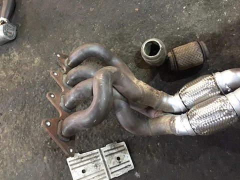

3. I thought that vibrations were caused by damaged fluted tube (two flexible tubes connected to exhaust manifold) and I have replaced them.

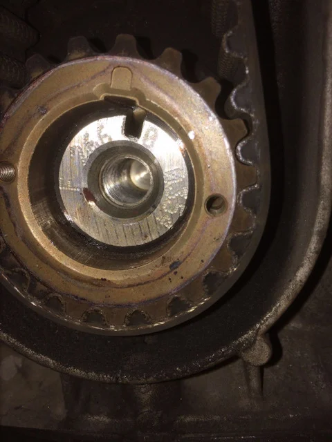

b) Сrankshaft pulley spline was broken and valve timing had 1.5 degrees offset
9. Valve timing belt was replaced, issues with motor/gearbox fitment and with timing were solved. I thought that we have found reason why my starters were breaking.

2. Operations with exhaust caused excessive heating of starter and despite the fact that we have no traces of heat and we have properly installed heat cover, mistakes with exhaust operations caused issue with starter.
