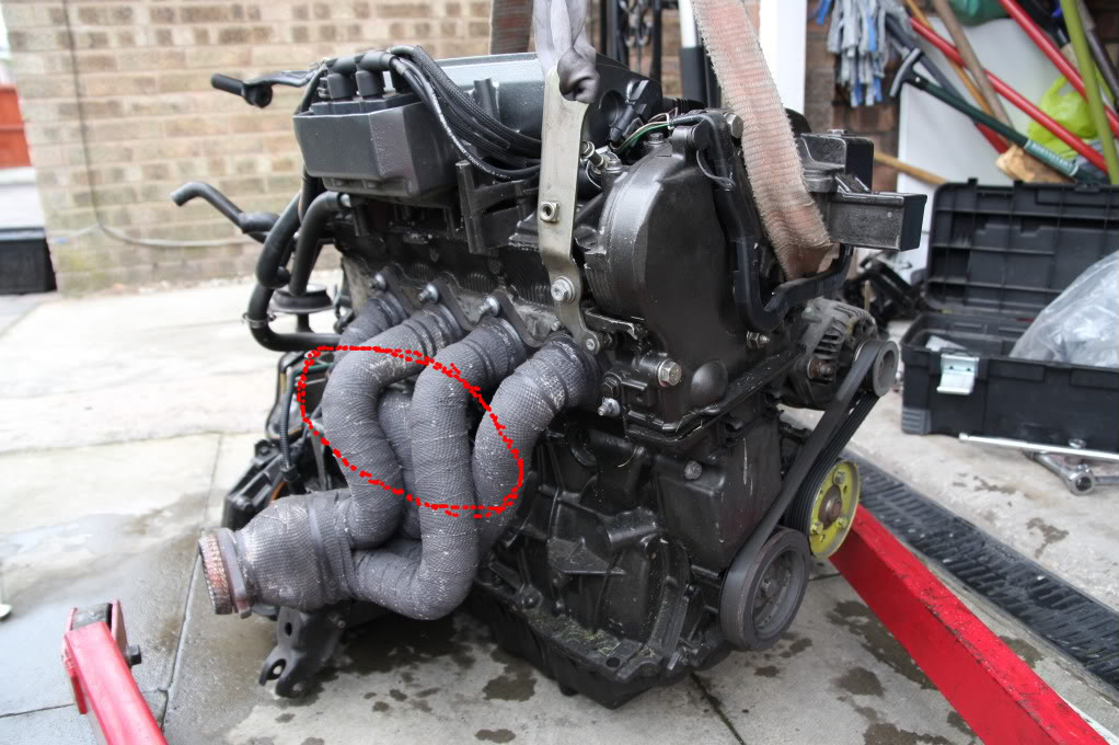

Can you push start it? if so its starter motorlong story short, car wont start, not turn over etc. so searched on here and looks like it might be a sticky starter motor. anyone got a picture of where it is in the engine bay, so i can give it a "tap" !
It's straight down at the front of the bay, kinda behind the numberplate area.
It's not going to be easy if it needs changing though, space is minimal down there!

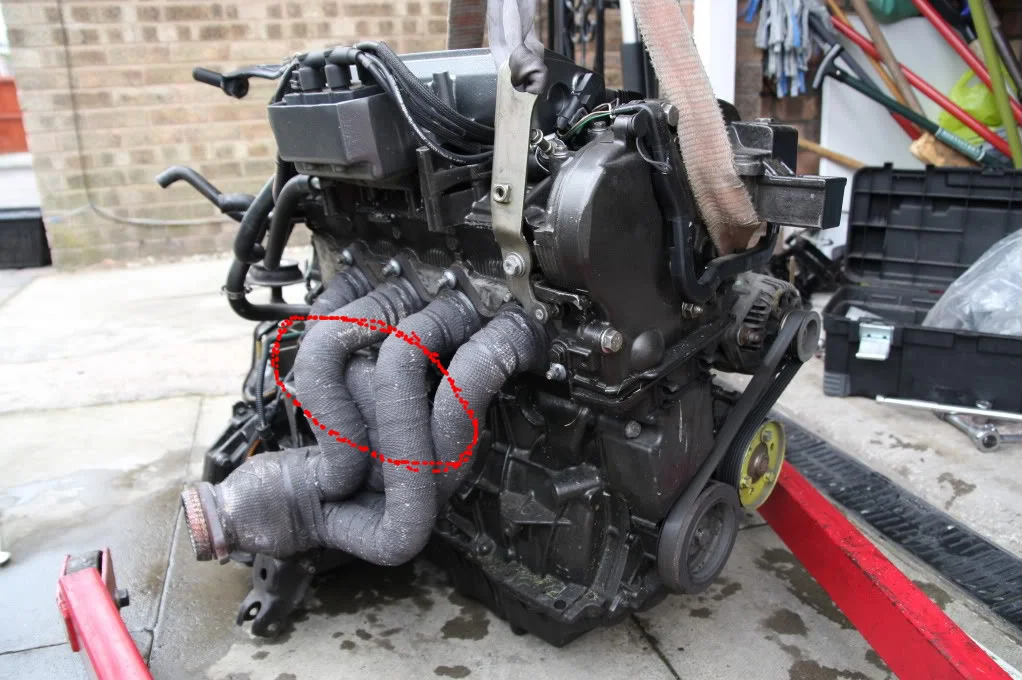

It's down the back of the block near the manifold, it's abit of a pain even trying to tap it. I used a long thin bolster chisel to tap it when mine was playing up.
Is it...?
I always thought it was at the front of the engine.
Is it...?
