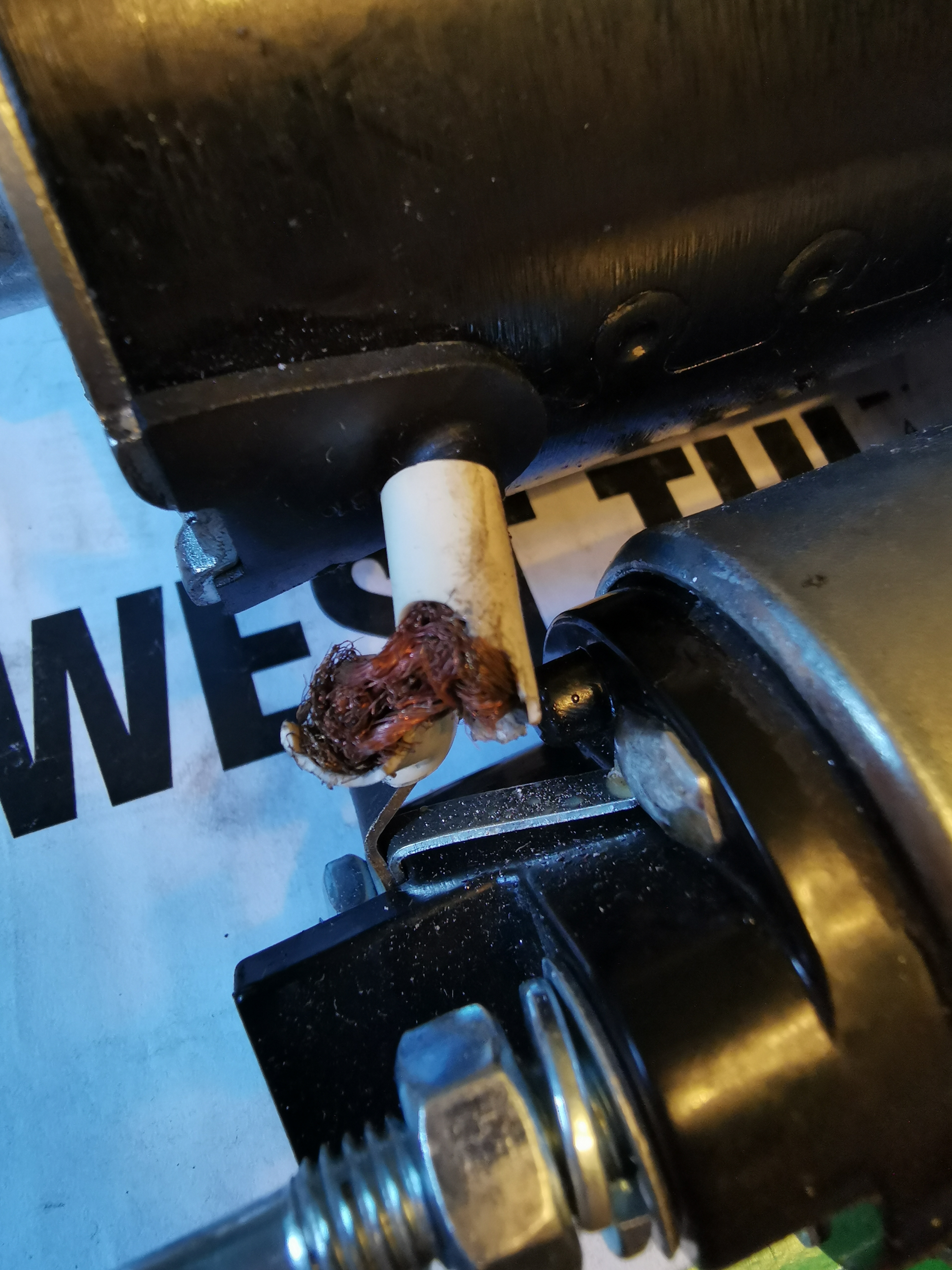

Clio_fool
If you get a starter from ecp do not leave the building without looking at it first. I bought the expensive one and it was fucked;
I took it back and swapped it for the cheapest one which looked brand new, but when fitted just didn't work. All available ones are refurbished.
I stripped and cleaned the oe one which was working intermittently and the issue turned out to be a dodgy connection.
