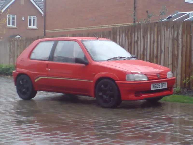

Stav's 106 Rallye
I love this little rallye, very very fast in the hands of stav.
