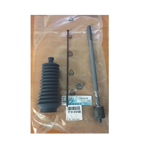

I have a 2005 Clio 182 with the cup pack suspension and need to replace the track rod ends as either they [or the inner joints] are making a creaking noise when I turn the wheel. The car has power steering and I was planning to buy Febi parts. The track rod ends are fine - there's a single version for the LHS and RHS - however the inner rack ends have multiple options for cars with power steering.
These are the parts from the Febi parts finder :
178261 - length 316
22763 - length 296mm [for steering rack manufacturer TRW]
22517 - length 301mm [not for steering rack manufacturer TRW]
Does anyone have any experience in replacing these and know how to determine which ones I should buy [short of pulling everything out of the car and measuring before I order] ?

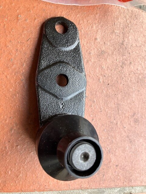

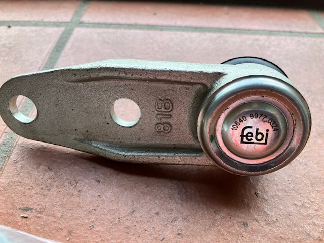

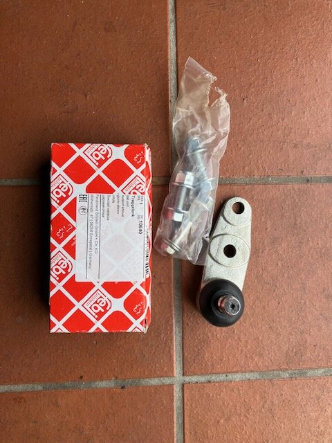

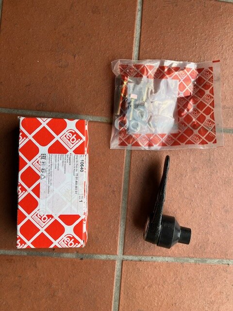

Just a silly question here. I bought a pair of Febi bottom ball joints from two different suppliers on eBay and have been sent different sized versions of the same part... one has slightly larger mounting bolts and holes than the other... even though they're supposedly the same Febi part number. I've a feeling somebody has swapped the box contents. So in the hope that one of them is correct, would you happen to know the diameter of the mounting bolts for the bottom ball joint ?
JamesBryan
The larger of the two.
Sport ones use M12 bolts, non sport are M10.

The saga continues... I'm trying to buy the correct one of these and was speaking to somebody at Febi who told me that they don't manufacture them for the Cup suspension... and that Renault don't have a part number for the Cup versions either ??!!?? What manufacturer's parts are you guys using and/or where did you source them.
Here are the two different versions of the same Febi part number that I mentioned above.
  Renault Clio RS 182
Here's one for you now. The guy from Febi told me not to fit either of the two I have to the car and to return them to the place I bought them. He said that Renault do not make that part separately for the 172/182 and that it has to be bought as a complete wishbone set [as in the Renault Parts Direct listing below]. He said that the Febi and Lemfroeder versions that we're looking at "will fail prematurely even if they fit" !
I'd be interested to know what those who race the 182 use as they're constantly damaging front corners etc.. and I'm sure getting throgh plenty. I'd imagine if they can withstand the rigors of racing, they'd be fine on the road.

Sounds like the febi guy is a "if it doesnt match your reg" then its going to end up in flames type of person.
The 172/182 balljoints are nothing special. If its a m12 type send it. Check pin thickness with a vernier if your worried.
