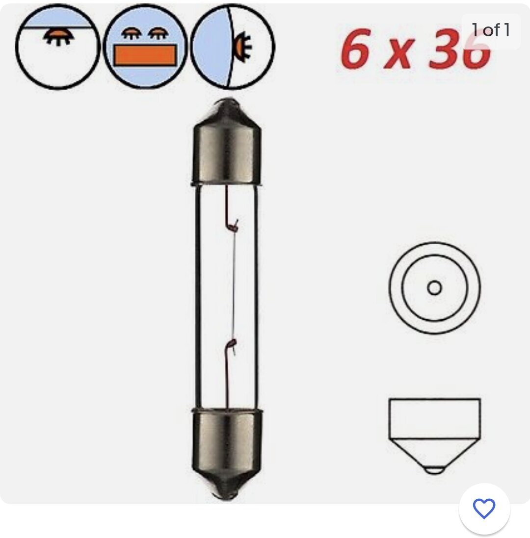

The standard bulbs are 12V 3W festoon bulbs but much narrower than the usual festoon bulb at only 6mm diameter rather than the usual 8 to 10mm diameter. Length is approx 36mm long and they look like this:
Not that common but can be found under SV6 or 256A designations. The pointed ends locate into holes in powered metal tabs within the sunvisor to hold in place. There are 2 bulbs in each sunvisor.

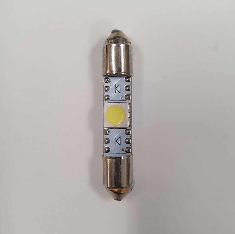

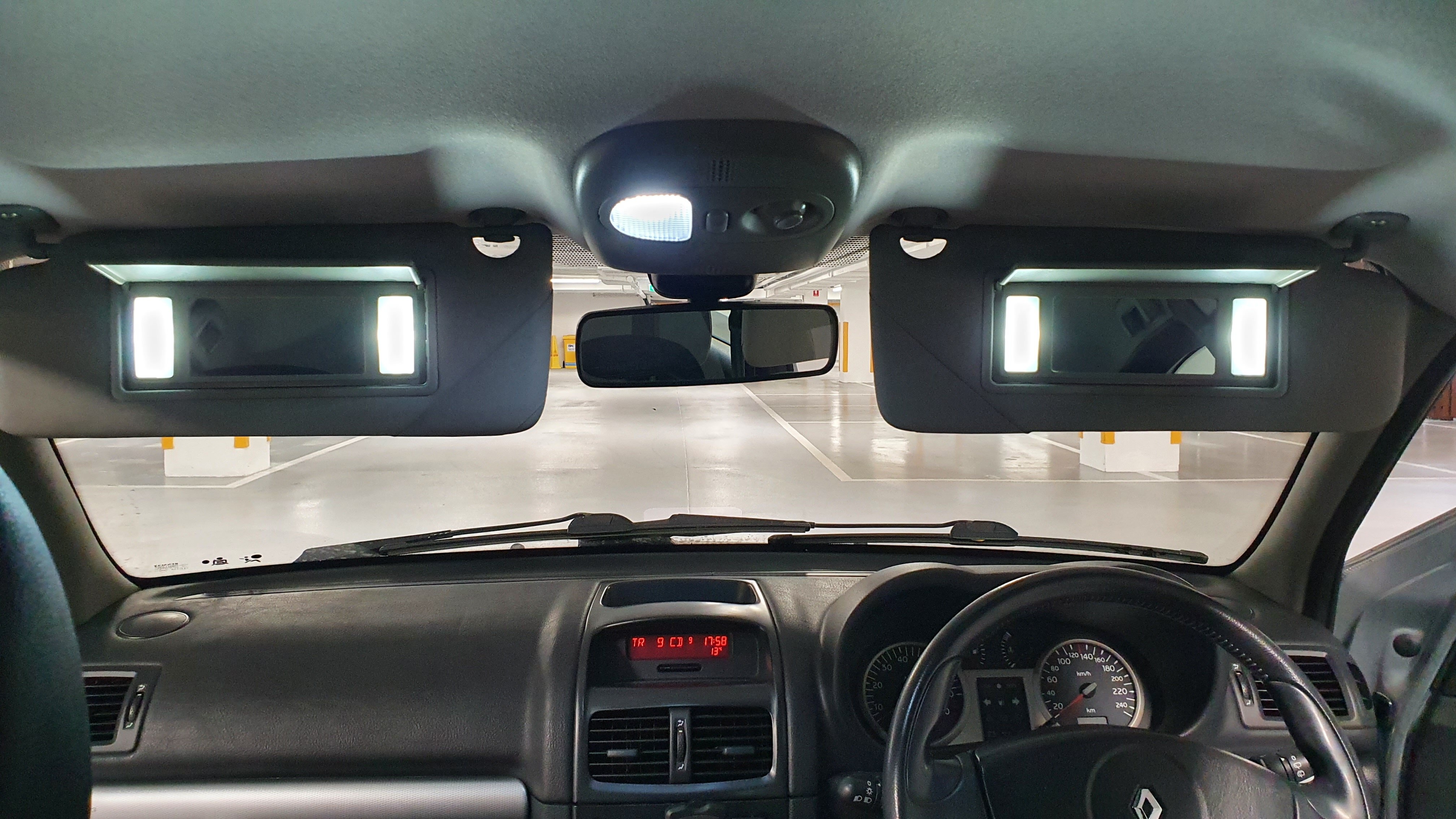

If you are wanting to convert these to led most festoon led bulbs are too large a diameter to fit. However I found that you can modify some 28-30mm fuse led bulbs to basically replicate the dimensions of the original bulbs . Carefully use a Dremel or similar to remove the pointed tips from the metal ends of the standard bulb and solder these onto the ends of the fuse led. The metal ends are glued onto the glass of the standard bulb, so I would recommend breaking the glass bulb first - they make a nice pop! - and use some small pliers to hold them while cutting the tips off.
The led fuse bulbs I sourced were from Diode Dynamics: https://www.diodedynamics.com/28mm-smf1-led-bulbs.html

Thank you for such a detailed response.
That’s excellent. 🙂👌🏼
