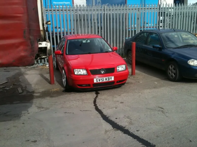

Would have thought the low VW boys would have got wise and invested in some sump guards by now knowing how many others have destroyed sumps before.
  Evo 5 RS
hate that feeling, get out of the car bop along into work and spot the trail...hoping like fook it ain't yours lol
_Tom
There was a stone in the road. Must have caught lovely between the ground and sump and there was a mighty noise. Im glad it didnt hit my fmic though tbh.
I did have engine raisers but really i need a notch to run them. It brings the sump above the subframe. But i also bring the drive shaft onto the chassis.

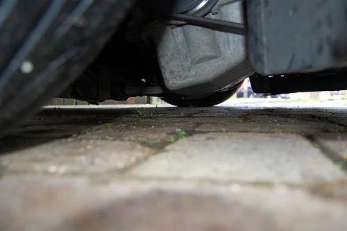

Im a little worried about a notch. If you crash is HAS to be a weak point surely.
Go on eBay you can get shallow sump kits for these engines I was gonna get one for my golf.
Link? Most advise to only go genuine. VW actually do a shallow-er steel one im going to look into.
ah the joys of low diesel sumps....lol
all i scrape is frame....
Mines petrol matey. ;) 1.8T.
I'd have similar concerns about the chassis notch. The cleaner option assuming it's tried and tested is a shallow sump or dry sump set up but the latter isn't cheap.

Ah all is going to be cheaper to sort than i thought.
£45 for a new sump. £20 to trailor the car home and £20 for oil and filter which it needed anyway. Not too bad really.

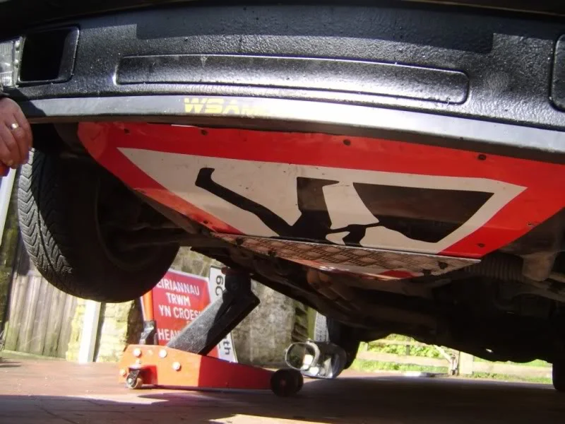

Can you get low profile sumps for these? Either way I'd fabricate a guard of some description. Road sign if you're pikey. ;)
_Tom
Yeah i can get a steel low profile one. Ive read that steel doesnt cool as well as alloy though so not a good idea to fit them?
As for the road sign, id rather know when my sumps leaking. It was the impact that made it go, not scraping. Although it did have quite a few marks.
