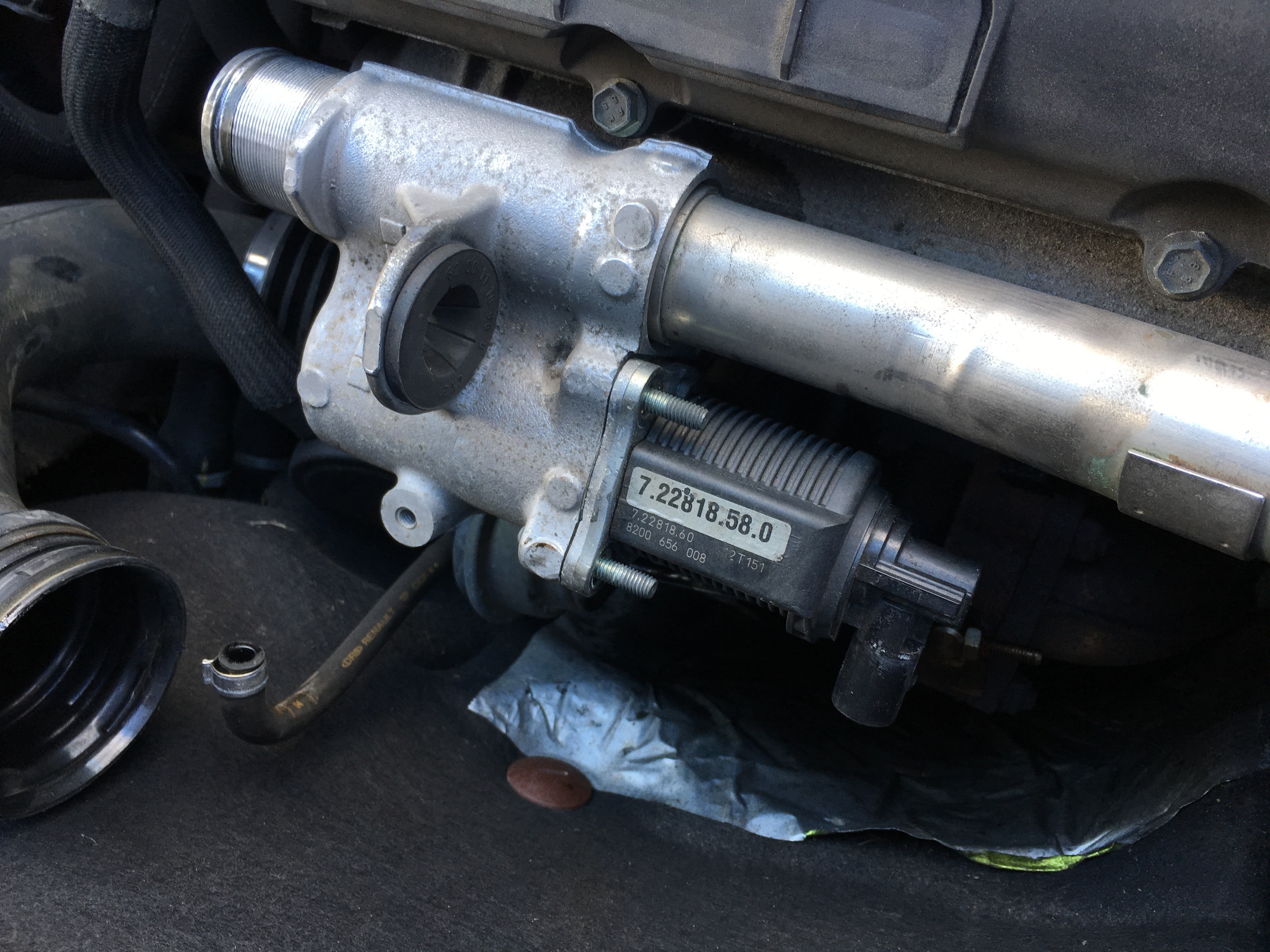

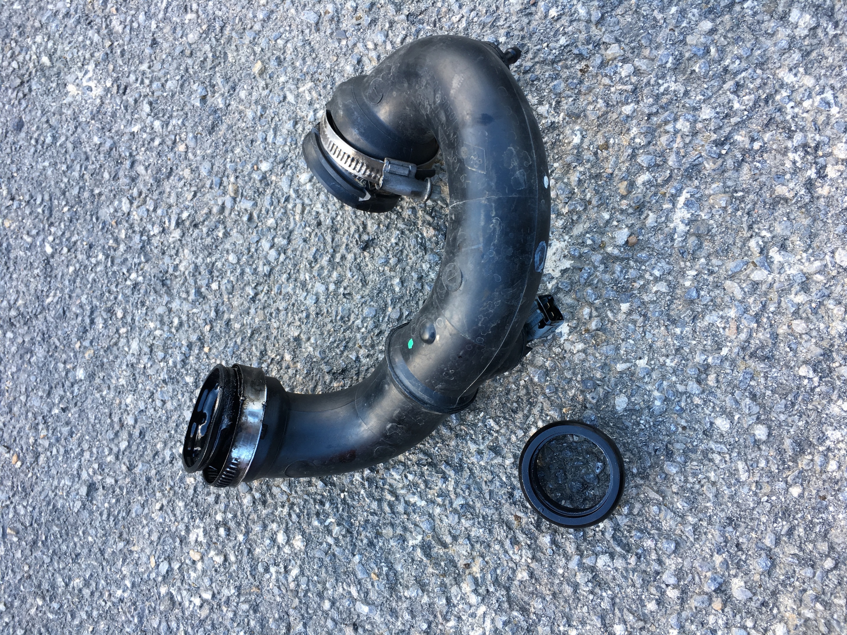

Egr stuck or knackered ? Check if the plastic pipe has come off turbo
This is whats happened! Just in the middle of doing it now. Or trying to lol...
Theres a small pipe part too which was still on the turbo. Any ideas? Like a plastic ring.
  182
  182

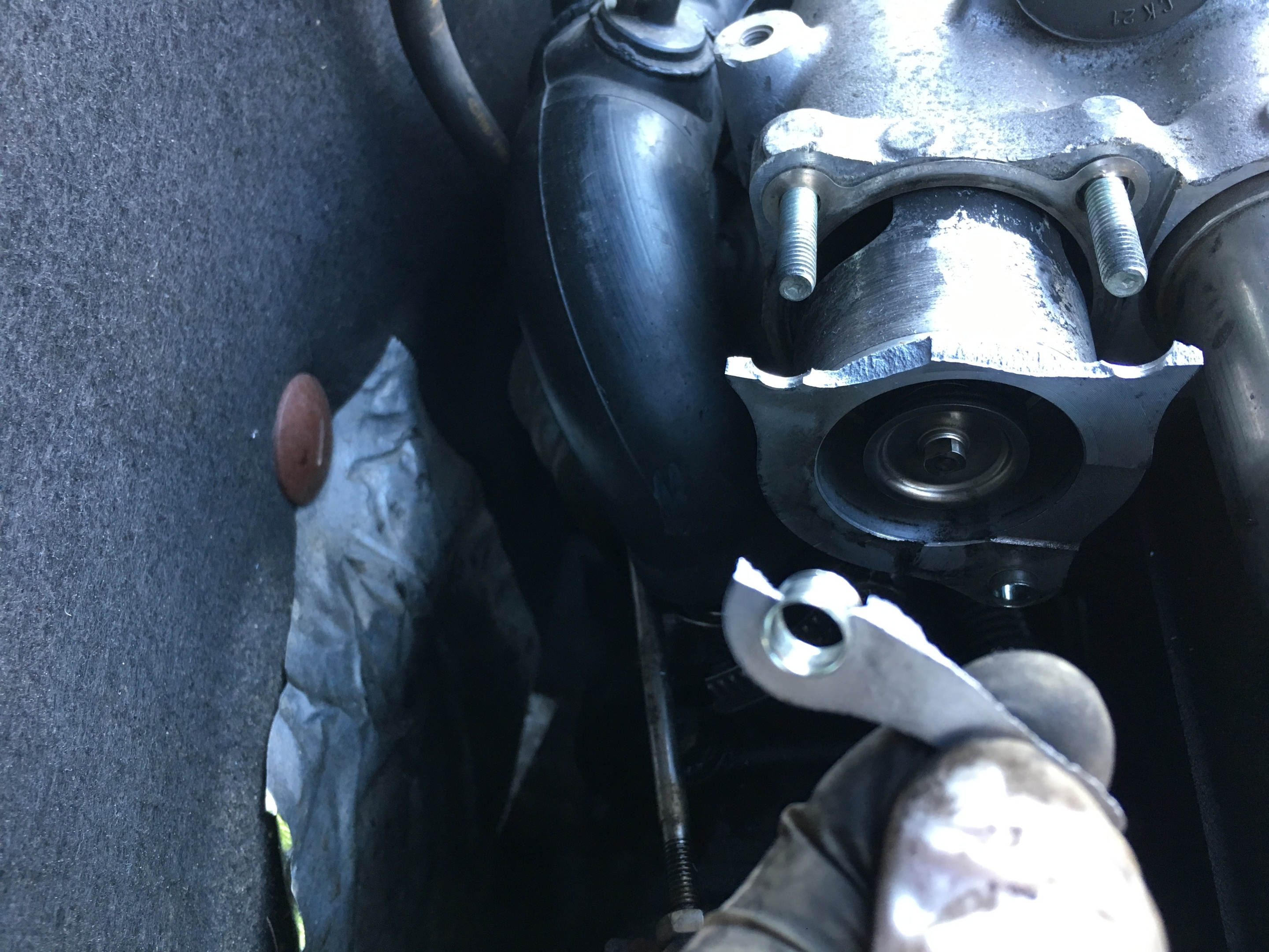

Managed to get the egr valve out as i thought it would be wise to see if it needed a clean. I ended up doing this while trying!!
I have put it all back together and tightened it up as the main park kees it all inplace, but will it cause any issues or should it be fine?
Just went out and its running like normal again.

Broken part not ideal but should be ok with 2 bolts until you get a replacement. Refitting the plastic boost hose is a pain the rubber bung is mega tight.
  182
Could it cause any issues? It seems to be fine and where it has broke away doesnt seem to affect the main part of it. Any idea if i can get that as a replacement or would i need a full new unit?
Yes the hose was a bit difficult but went on easier when i attached the top piece first. Why would it of popped off in the firat place? Im worried it might happen again now.

Yes sir thats me thought i recognised the name! Been a member for a while just started posting. You will need the inner half of the egr get one from the scrapyard for nowt - engine is shared with lots of other models. Yours looks pretty knackered now should work but not ideal with the lugs missing.
Nip the hose clip up tight on the plastic pipe should be ok make sure the jubilee clip is not catching the actuator rod. Also check the rubber has not popped into the pipe or you will have a boost leak. s**t design i was chewing on with mine for ages when i changed turbo
