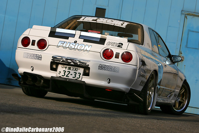

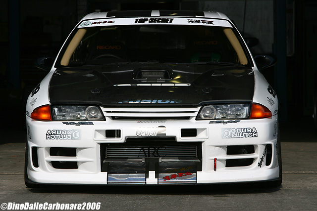

What's this ;)

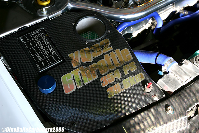

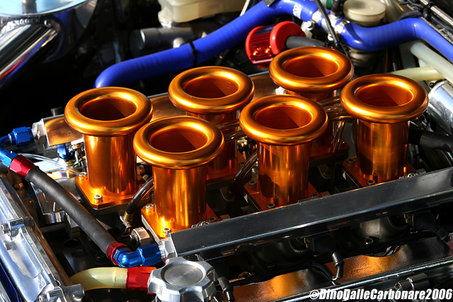

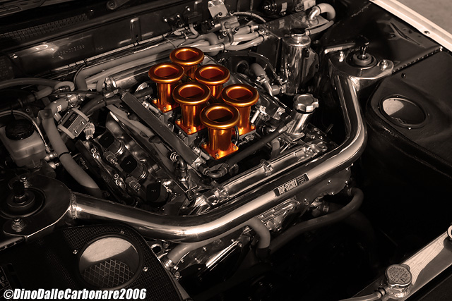

BNR32 with a vq32 engine...
you take a vq35 engine and put the crank from the vq30 engine in it to get the vq32
edit its a topsecret car lol
lol she is a woman ignore her :D looks nice though, im getting a bit of a liking for nissan g35's!!
vq32
its a v6, basically a 350z engine... but originally 3.5l called a vq35, they have then taken the crank out of the 350z engine the vq30, and put that in to the vq35 making it a vq32, they use it in jgtc cars...
