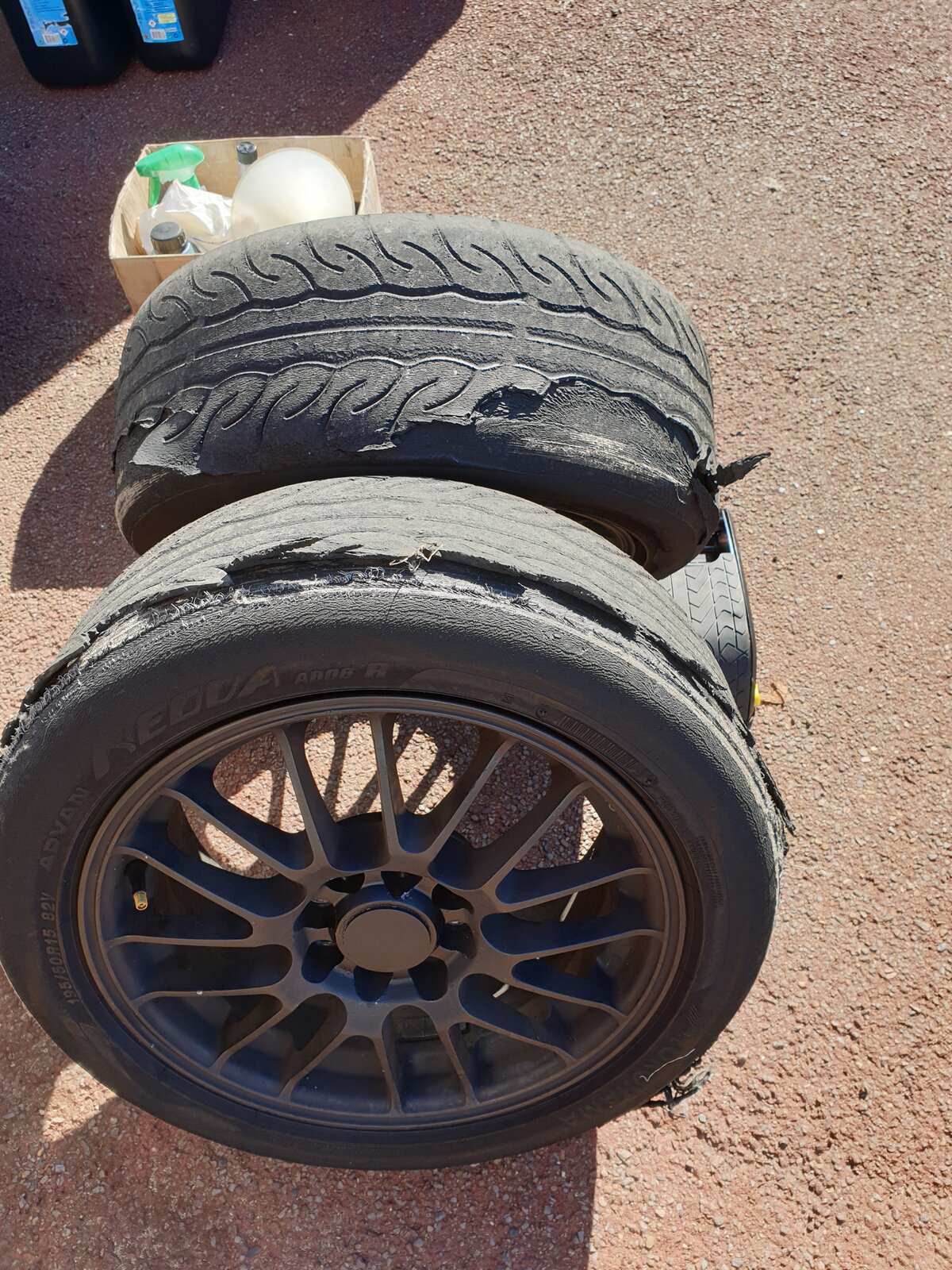

When I wanted to refresh my brake fluid, I noticed my tyre have excessive wear on the outsides, and they are colored blue.
What does this mean? And how do I solve it?

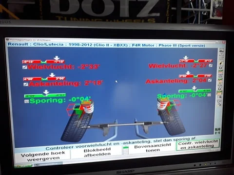

Do I need to change my tracking? Currently it's like this.
The top one is camber, then caster, then toe.
Hot tyre pressure after each session is checked, and is regulated at 30 psi.
I've noticed that a lot of heat is created with the tyres/brakes after each session. I also feel, that I lack grip coming out of the slower corners. I've always put this down to the low weight of the car, but hopefully someone here can shed a light on the tracking if that might be the case.
I'm thinking I need more camber, but that will also effect my braking. Will more caster be advisable to give more camber just in the corners?

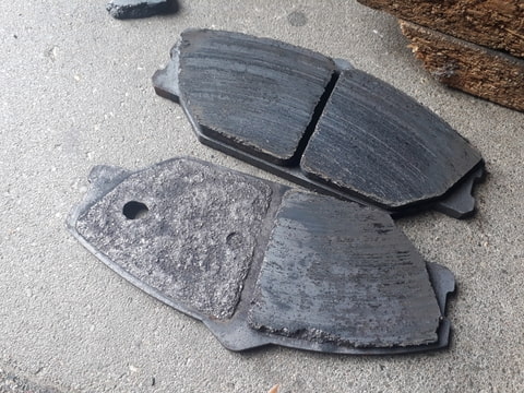

Another issue I discovered is this.
My left brake pad has crumbled. They are Carbon Lorraine RC5+ and I did my first trackday with them in march 2018. Since then I did about 8 to 10 trackdays I think, with an average of 4 to 5, 20 to 30 minute sessions. Is this normal that they gave up after this amount of track time?
Might it also be heat related that they have crumbled? Should I upgrade to RC6 or higher, or a different brand of brake pads?

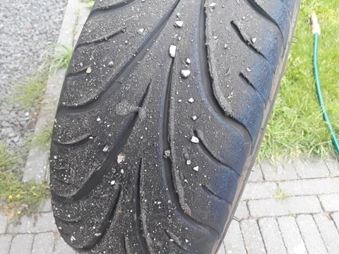

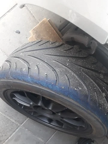

The blue on the tire is just oils coming out of them which happens after they’ve been standing for a while after a track day or race.
The wear could be down to wrong pressures but could also be your toe.

Your camber should be ok like that.
Too much camber and you’ll have even less traction out of the corners.

On closer inspection I wouldn’t say that wear is too excessive, but keep an eye on pressures. Do you have a tire thermometer? Also useful to know that you have even temperature across the face of the tire
Everything seems fine, CL5 are renown for crumbling my advice would be DS1.11. Its the tyre itself which will be the issue. RSR's are budget track tyres, so give budget grip similar to NS2R 180 etc. Upgrade to a mid-range or premium track tyre and the difference will be night and day.

Yes I forgot to mention CL RC5s, 6s et al are prone to crumbling which is apparently caused by moisture. So if you’ve had a wet track day or your car has sat outside this is a common problem.

Wear looks fine.
I guess I could borrow one at work. So the blue lines is nothing to worry about? And wear like this is normal? You can clearly see in the first picture that the thread in the blue area is almost gone.

So basically I've reached the limit of the tyre? My plan always was to work my way up with the tyres, I started on normal street tyres, now these Federals, and after Toyo's or something?

Exactly mate. Look at at something like the AR1, R888, ZZR, A032, V70a, Dirreza etc. Not AD08R, NS2R 180 etc

It's rolling the sidewall over a bit. Probably try 32/33psi instead.

The pads are sintered metal so quite possibly stuck to the disc when in storage. I cant see any evidence in that image they rusted internally but a years worth of use is pretty good considering the caliper.
If you want to discuss CL and other options I can help. I deal with a lot of Renault track cars so always getting feedback on whats working and whats not.
I've already been in contact with you. It was me asking about the lead time for the Ferodo DS1.11 pads. Just waiting for a friends reply to see if we combine an order.

Yes, CL5+ need to be kept dry so if it's going to sit around outside exposed to the elements then have a cheap set of road pads to put in after track days.
Your camber looks fine 2.5 to 2.75 is what guys usually run.
Most run 10minutes tow out or more as when you accelerate in a fwd car you wheels naturally pull forwards reducing the toe out. Castor and toe out increase turn in.

Its a small pad surface and the caliper is small so retains heat. Also as its a single pot so one pad side will wear faster.

I supply to lots of 172/182 track and front running race cars their brakes, and plenty now running DS1.11 after trying various others (and having issues with others) . They just work well, combined with the rear DS2500 , one of the best set ups you'll get running the OE size brakes .
On the shelf at Road Trace Race Parts and can have them tomorrow, with discs, fluid etc etc @scullyg40 get in touch I'll get you sorted (y)
The higher pressure was mentioned because it's just a road tyre and that usually prevents the sidewall rolling over.
If you ran Dunlop Direzza's you'd comfortably be able to run them at mid to high 20's without the sidewall rolling.
