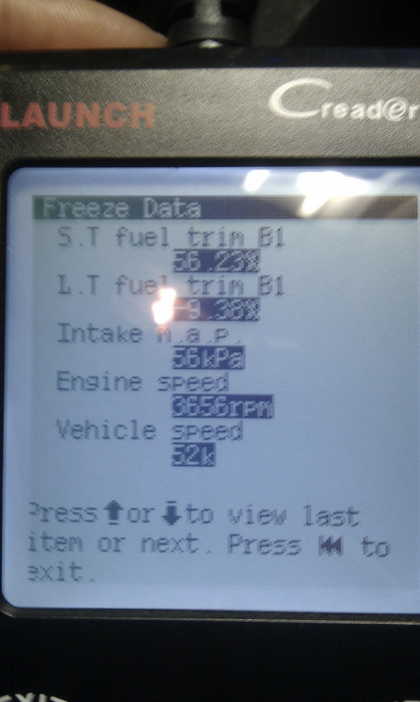

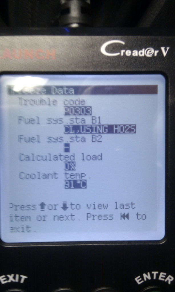

My fault code reader brings up 'P0303', and refers to a misfire on cylinder 3.

Any ideas would be helpfull?!? Have had a read of all the other threads of similar problems and have list of things to try i.e. injectors, coilpack, TDC sensor. Will fit my new lambda tonight to see if it cures it.....
