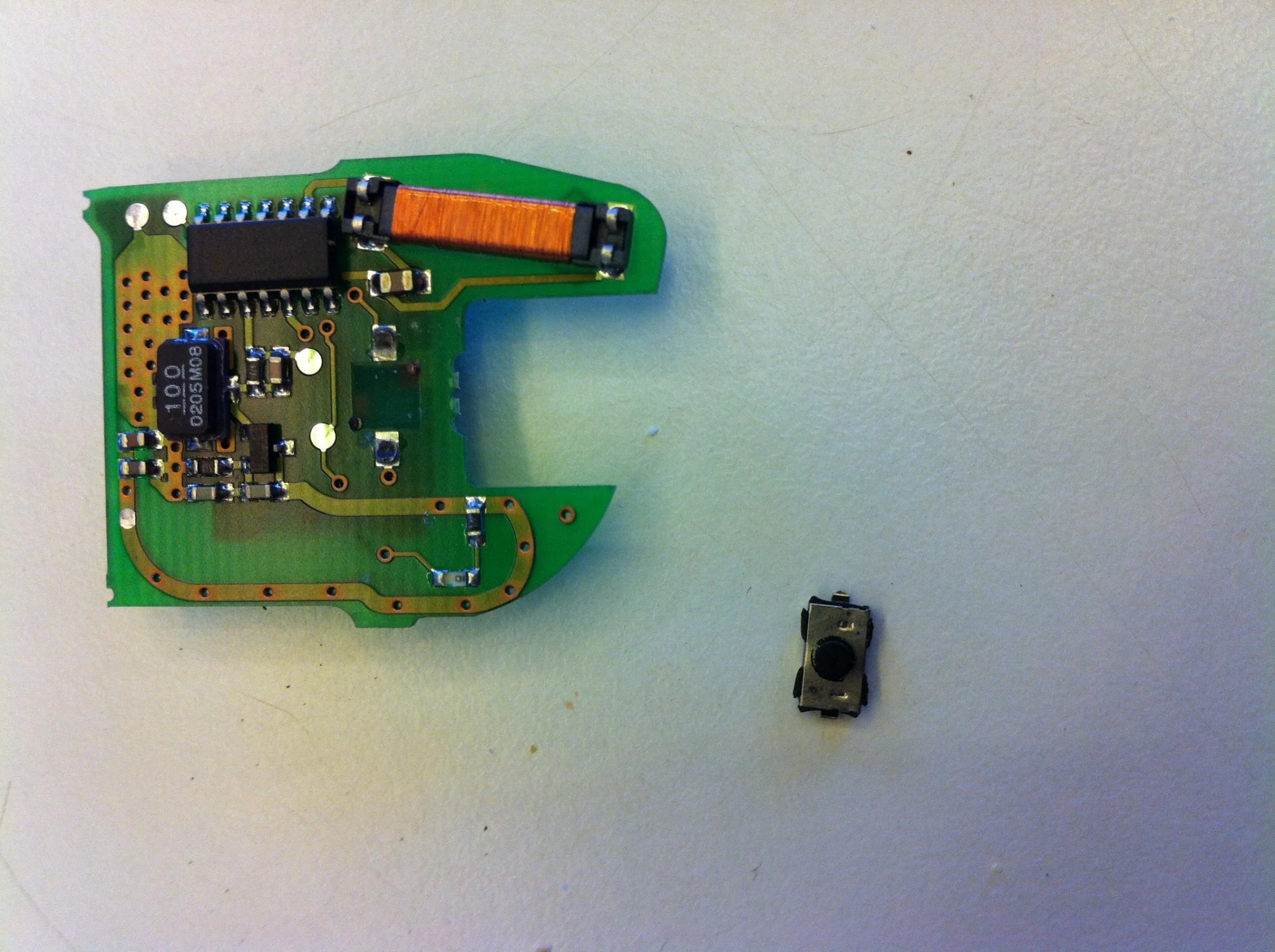

the little push button which is mounted to the circuit board inside the key unit has broken off.
this has stopped my button from working.
can anyone help with information on how or where this could be fixed, really can't afford a new one.
I can still use the car with the key but every time I open the door my alarm goes off and will stay on until I start the car.
cheers

I reckon you could solder that mate, or maybe a friend who's good at soldering could do it for you? :)

Easy job, just needs a spot of solder. I even taped my old one on lol, was fine for months then i decided to solder it back on.

It would appear the one of the little tabs on the switch itself is broken off.
Any ideas abour repair or replacement of the switch?

Yes, soldering with a fine tipped iron will sort that. Failing that buy a new button

If you don't want to solder it you could always put a blob of super glut on the back of the button and hold it in place until stuck!
This happened to mine the other day and I just soldered it back on.

I have tried that but was unsuccesful.

Cheers, went out and tried that. Sorted now.

the exact same thing happened to me 2 months ago, i re-soldered it on, then it happened AGAIN. so 2 weeks ago when it happened again i opened up, had a look turned out one of the solder plates had broken this time, luckily i managed to solder it back on, how it even has connectivity without one of the solder plates i dont know.
