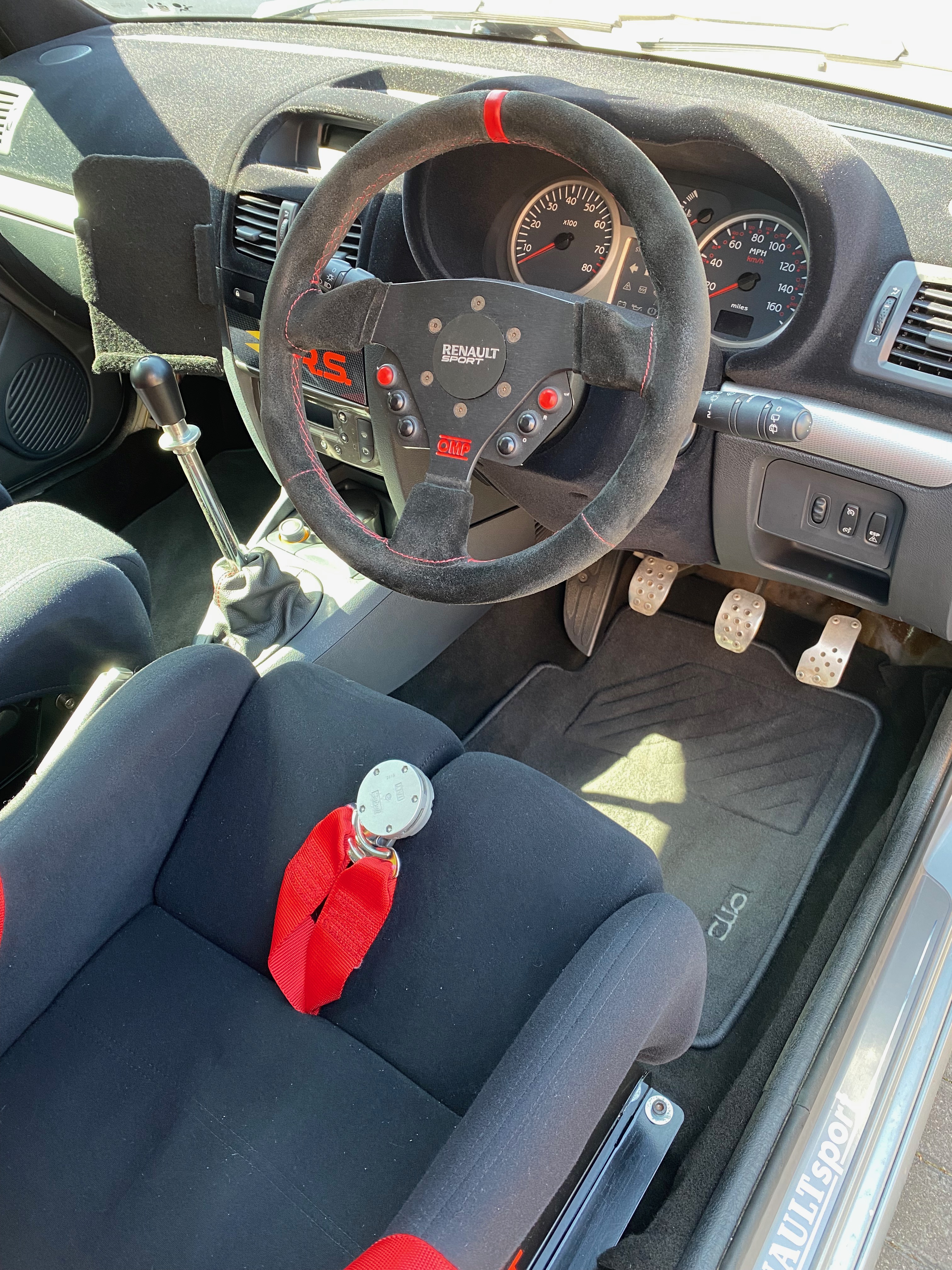

  Clio 172, i20N
Here's mine. Red on top, black bottom two.
