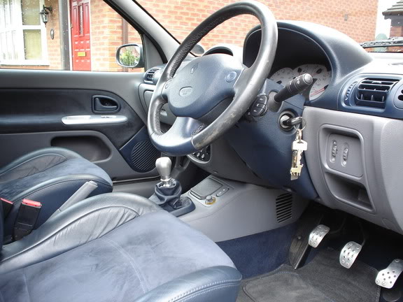

here is mine....and i f**king love it
the standard gator does take alot of playing with to get it perfect.
- oh and maz yeah u are a big girl:)
Dont know what some people are talking about, the only way u have probs gettin it into reverse is if u installed it wrong... gator fits perfect.
