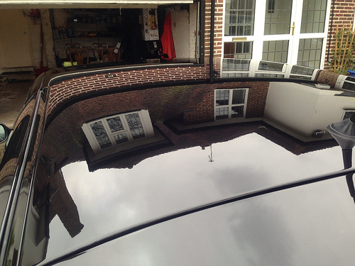

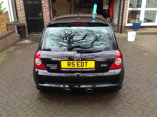

in the last 6 or 7 months ive got in to detailing my car, always kept my car clean and polished but not to the point of detailing
since i had my car detailed by detail uk in tamworth it has been a real eye opener on how to properly clean my car and the difference is amazing especially the gold fleck (bg 182)
basically i would like some advice on my washing stages and any stages or products im missing
my products are all chem guys apart from iron x
Basically i start off with a Chemical guys honeydrew snow foam then while soaking i put iron x on all 4 alloys
leave few mins
then i jet wash the alloys off then use a open ended hose to soak the snow foam off
then i use glosswork soap using the two bucket method and also a lambswool mit - doing one section at a time and soaking off using open ended hose
then i dry the car off using a fatty orange microfibre drying towel
i then leave the car for 15 mins as the drips are unstoppable
i then cover the car in v07 to get rid of any water marks - normally on boot and under wing mirrors
then i give the car a full go over in gloss work glaze using a microfibre for on and a clean one for off which i do a square foot at a time
then i apply wax to the car which is petes 53 (made for black cars) which i use a ufo applicator then a microfibre for getting off and once again doing it in a square foot - sometimes i apply two coats of wax depending on the time between the last wax i gave the car
then to finish off the body i seal it with V07
then lastly i apply tyre trim gel to the tyres and plastics (splitter, mirror surrounds and rear bumper trim)
then i give the inside a vac, rub down on the dash and a small wipe over the centre console and grab handles with tyre trim gel which brings out the little fleck in the plastics
then i use some watermelon car freshner to finish off then i have a very shiny good looking car
so basically have i missed any steps? any better recommended products rather than the gloss work glaze
and lastly is there anything i should do to my carbon fibre badges

pressure rinse the snow foam of to remove a good amount of dirt before washing. helps stop you further wiping dirt round the car.
When rinsing after washing, then use an open hose as this causes the majority of water to sheet off aiding drying.
Gally
Yes but that's just before drying to remove most of the water, not when you're snowfoaming.
  PH2 Flamer
You also use tyre gel on the interior grab handles?
May looks nice but don't you get greasy hands and fingers whilst opening and closing the door? Or am I mis reading it?
Pressure wash the snow foam.
Also no decontamination to the paintwork, Tar/Iron remover.
Other than that it looks like a very comprehensive list.
