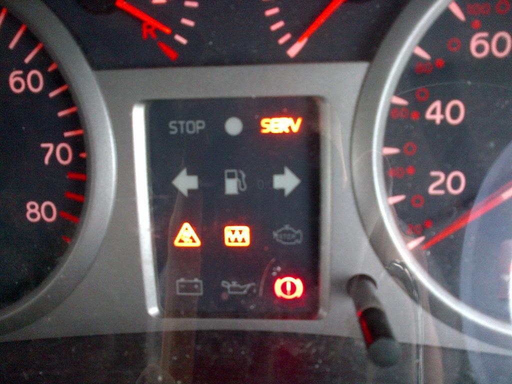

When it hit around 3000/3500 rpm there was a huge mechanical bang, then it started revving erratically from 1k to 2k and wouldn't let me have any throttle. Basically was like Limp Mode but it was revving like crazy all on its own.
The following warning lights came on when this happened....
Pulled off the road into a side road about 200yrds after this happened, turned the engine off due to the revving problem, and left it for a few mins while i looked under the bonnet as I initially suspected a belt had gone. Thank god they are all in tact!! When i started the car to carry on home, all the lights that came one, went out.

It it will be a throttle fault. Either a problem with the pedal, throttle body or the wiring. (Or possibly the ecu but this is very rare).
Get the codes read on a proper machine.
  Clio Sport 172 Ph2
Could possibly be the electronic throttle body gone faulty....... this wouldnt have caused that huge bang though you were talking about.
Seeing as the revs are up & down.... you could do a visual check on the butterfly flap in the throttle body, by taking the air intake pipe off.... & just see if the flap is opening & shutting as the revs are hunting up & down. Also check for any vacuum leaks also.
