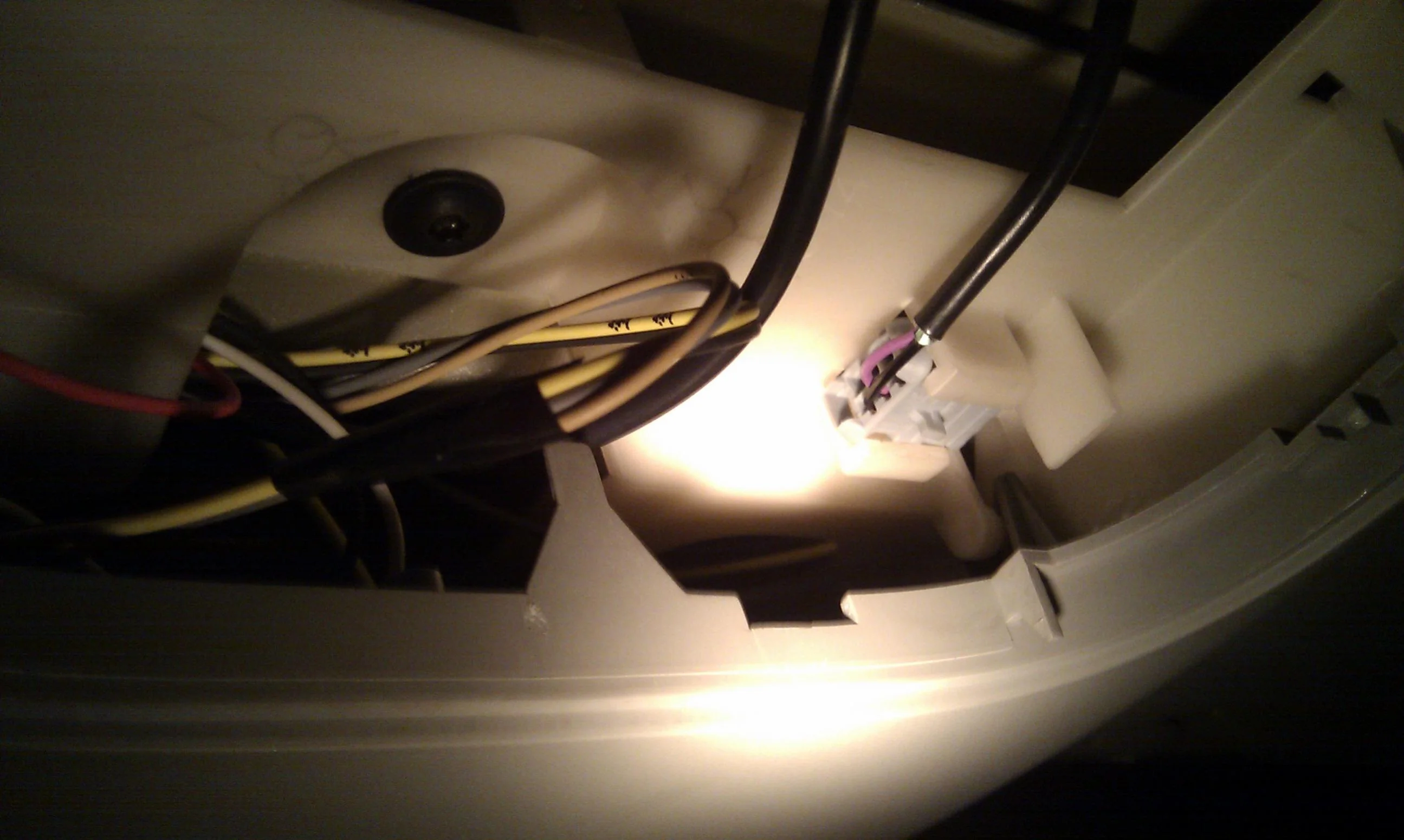

What is this for?
  CursedTitanium 182FF
What is the small grey plug behind the interior light housing for?
  Black Gold Trophy
Handsfree telephone microphone, if you remove the panel above the ash tray there is usally a loose connector for the handsfree speaker too
  Black Gold Trophy
Oh and under the glovebox you should find an unused 8 pin connector to plug the handsfree unit in, shame they only did one for the nokia 3210 or something ancient like that. I suppose you could cut the connector off for the phone and providing you knew the pinouts for the phone you intended to plug in and you had a spare plug for it, you could easily rig something up to charge it and send/receive the speaker/mic signals.
Thx for the answers all, I shall have to have a look at it & see if I can figure out how to get it all working with my HTC.
  Black Gold Trophy
Youd still have to order a mic/speaker from renault, that is if you want to use the standard connections
  A.N. Other
Don't bother, use a Parrot BT device, or similar, connected to the stereo wiring loom - much easier and likely cheaper in the end.
