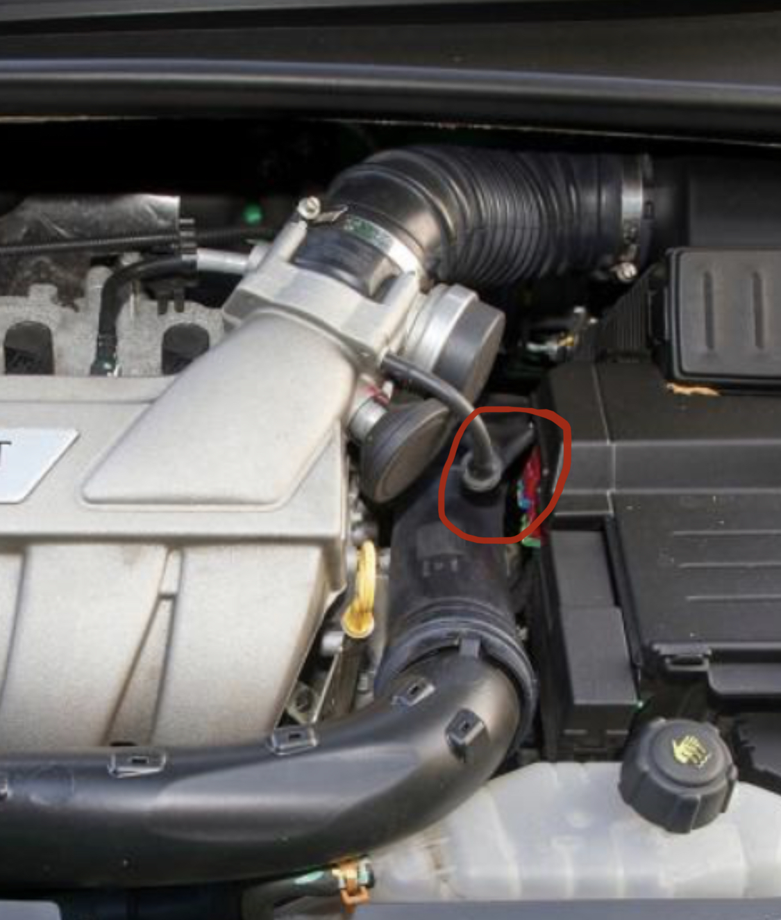

What is this part please ??????
  RS200 Cup
Please can some help me ?
What is this small one way valve ?? I think it’s blocked ????
Thanks.

  RS200 Cup
I’m having an issue with unstable idle ??
This valve on the pipe seems to be blocked ???? Thanks.

Its a vac feed to the acoustic valve on the inner wing. Certainly cant see it being the cause of unstable idle. Has it had a cambelt recently? Belt timing is probably the biggest cause of unstable idling.

Hi mate,
Funny enough the cambelt is being changed next week so fingers crossed [emoji1696]
Cheers.
