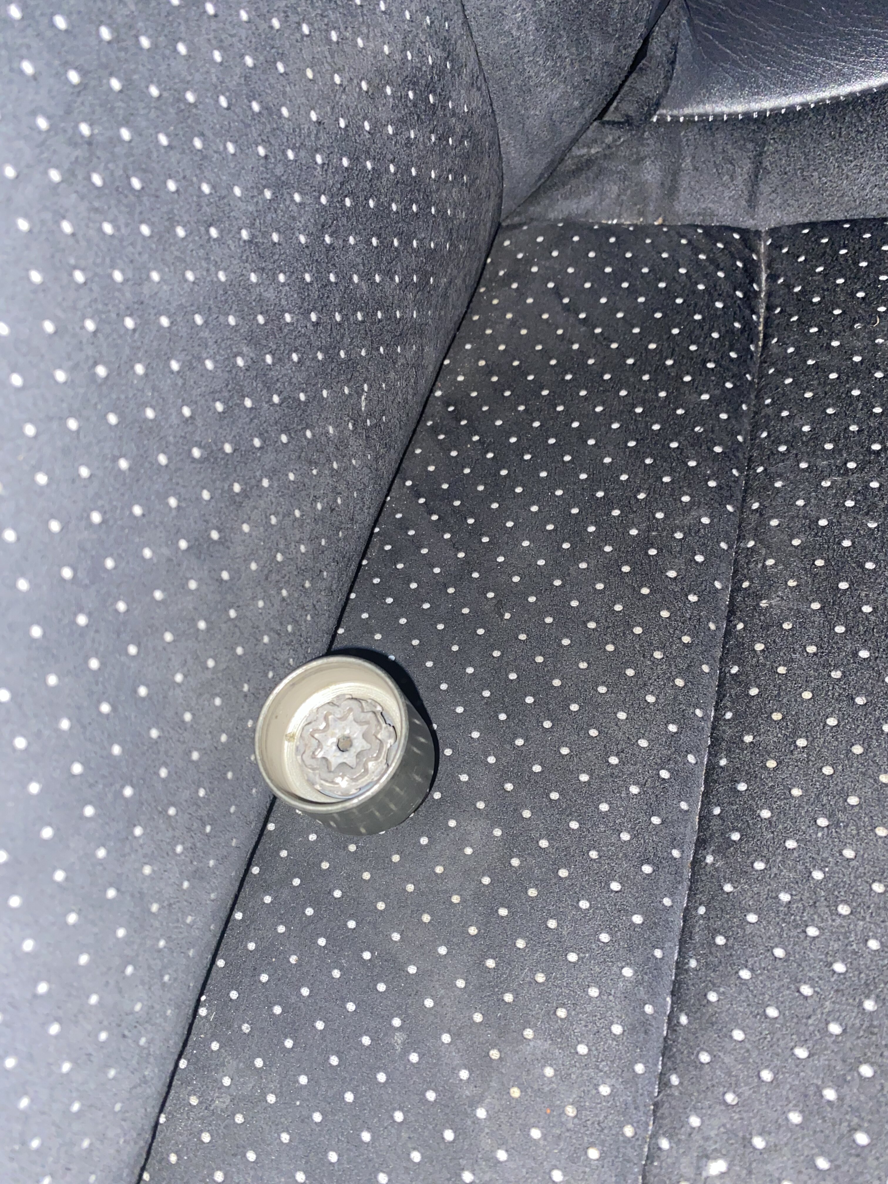

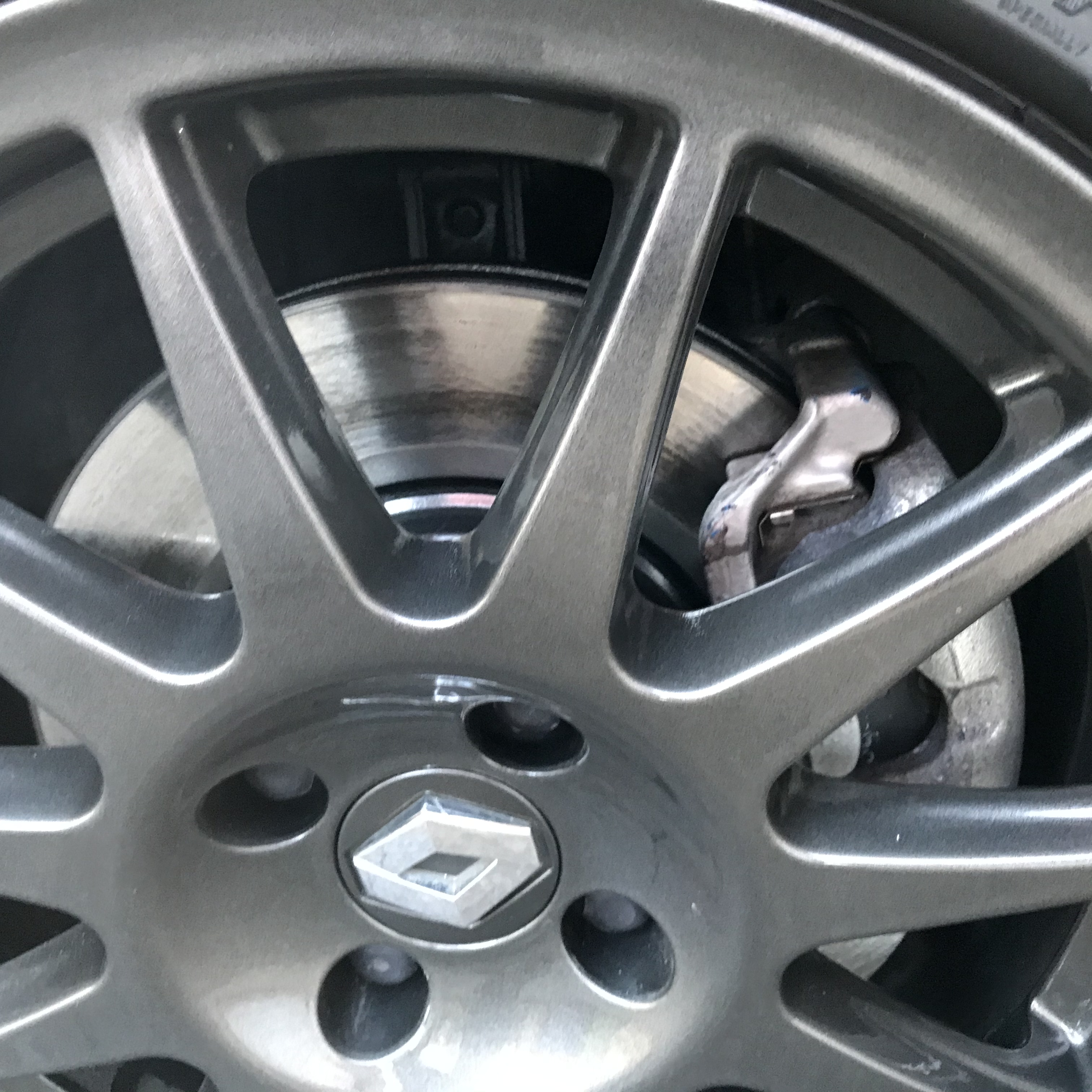

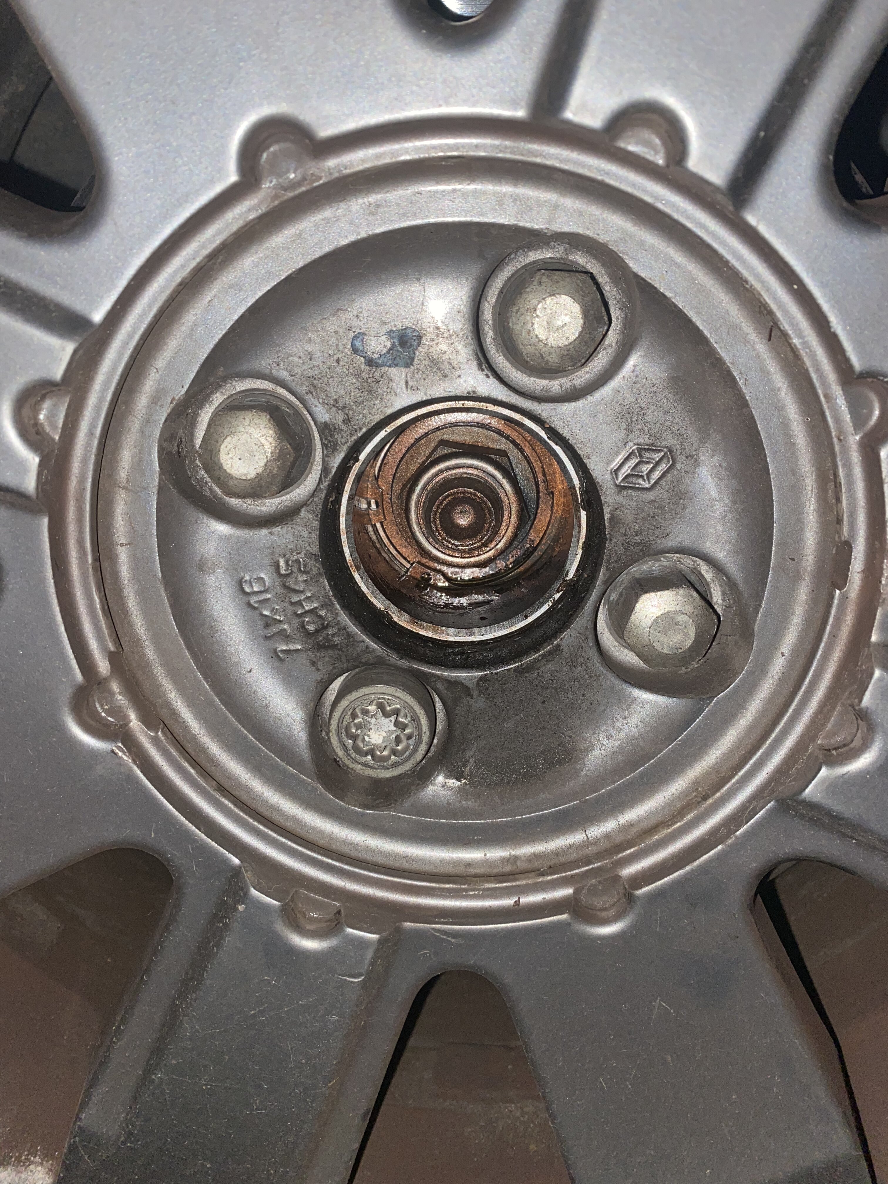

I’m putting some 172 turinis on a 182 but the standard 182 nuts won’t fit or will just about but no chance of getting a socket on them. What wheel nuts are used with turinis. Can anyone advise please. Thanks.

I’ve got standard 172/182 wheel bolts on mine and I’ve had turinis, 182 wheels, steel wheels, williams wheels, TD 1.2’s on my car and only ever used the standard bolts. 🤷🏼‍♂️

I have the cup offset 38.5 ET Turini's on my 182's with standard nuts.

to be honest he could have maybe just about got the 3 normal nuts on but didn’t want to damage the wheels with the socket piece as it was such a tight fit. The locking wheel nut socket piece won’t even go in the hole so no chance there. He suggested getting slim bolts that have an internal hole to put in a torx or hex attachment. Do you have locking nuts on them or just 4 normal bolts?

They’re my current bolts
hopgop1
Locking wheel nut key can easily damage the nut holes if you're not careful, I just binned off the locking wheel nut and went for all normal bolts. Also got a slim 19mm impact socket for good measure.

Yes I know they’re the standard ones. The garage couldn’t get the turinis on as the bolts wouldn’t fit. They are proper Renault turinis off a 172. They have been refurbed so maybe the coating is too thick? The 3 normal bolts would go in but he didn’t want to damage the wheels with his socket that was tight but the socket for the locking wheel bolt is no where near going in the hole

Suppose they are 19mm heads. Could always swap them to ones with 17mm heads for a bit more clearance. That’s what I’ve got but just because they come with the spacers I use. I binned the locking nut off on mine, they were just a faff and always piss me off.
Halfords do an impact socket with a plastic sleeve that I can highly recommend. No need for it on my Clio, but on my 335 the holes narrow and deep and that stopped any unwanted damage
