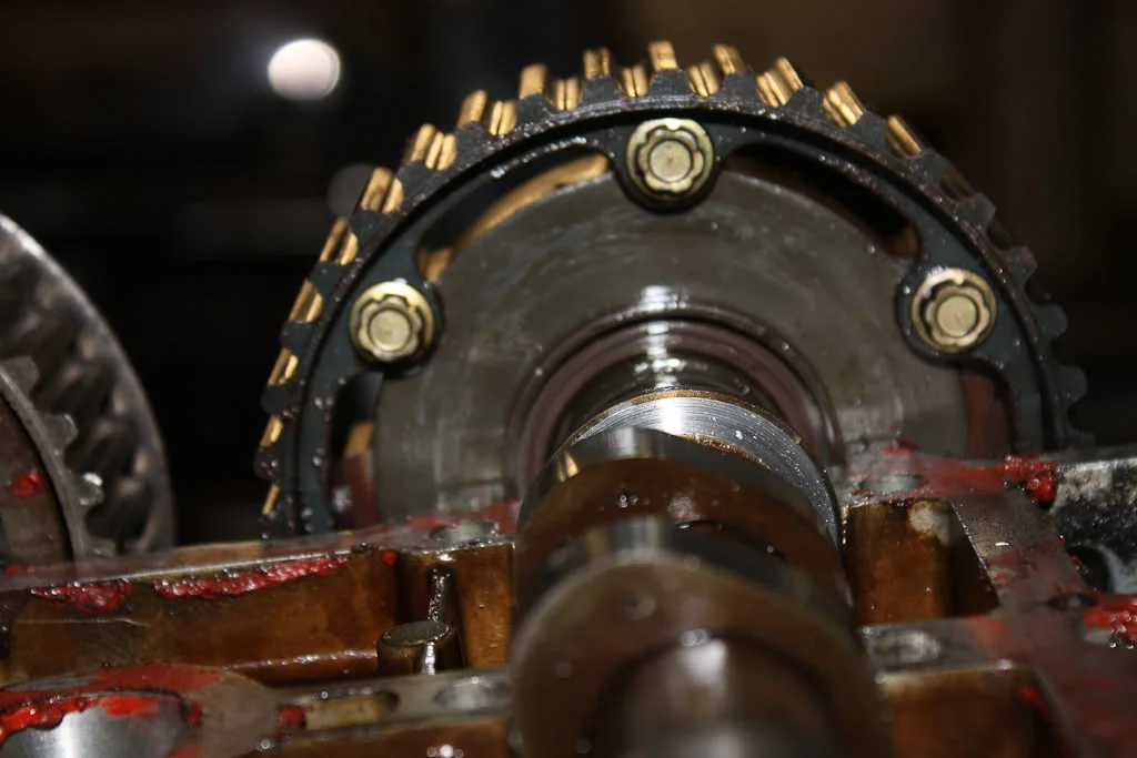

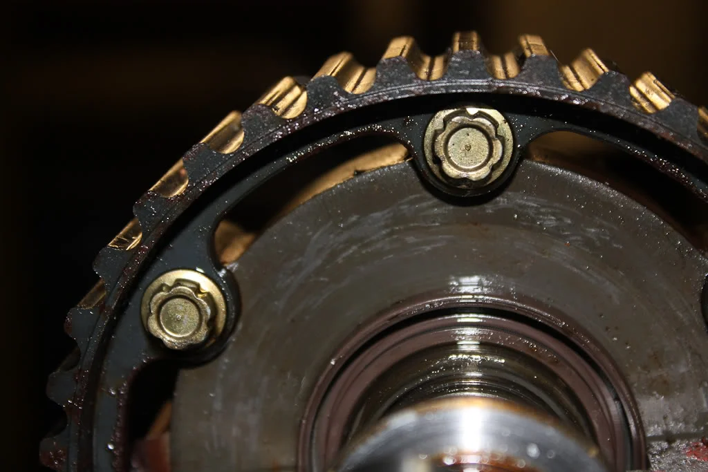

Whats This Bolt Pattern?
After a bit of looking around, it looks like a RIBE / Polydrive head. But, I can only seem to find those types in male tools, where I need a female one.
Does anyone know what the pattern is? And where I can get a tool...

That looks similar again yeah. Everything seems to be male tools again though, rather than the female version I would need for the bolt!

Doesn't look like e-torx to me in the slightest, far bigger flats on it. Does look like RIBE but I can't find an external socket for them either.
No worries, ive been informed the easiest way to get them out is to tack a bolt onto the back of them with the welder, then undo and replace with proper headed 8.8 bolts.
Thanks.
http://www.uktools.com/ Search Koken EPL sockets External torx plus ehardware on line sells some external JTC ribe sockets but I think you have external torx plus. Ribe has a flat end torx plus slightly rounded end.
