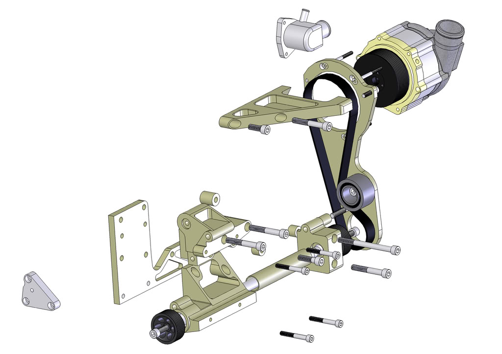

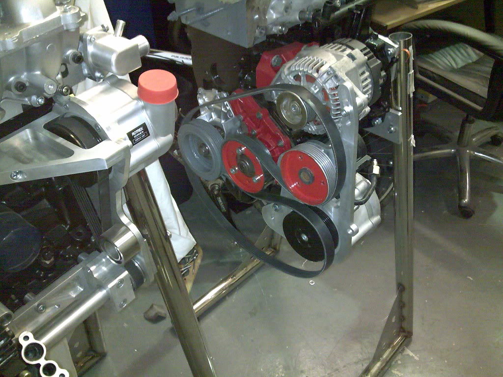

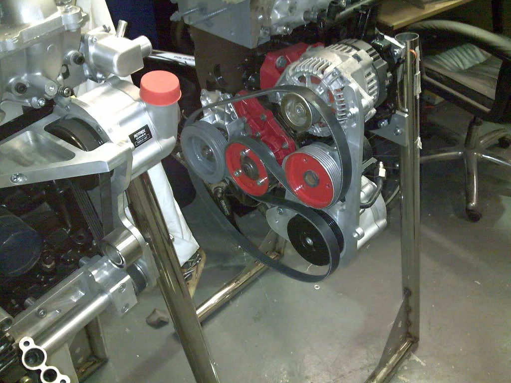

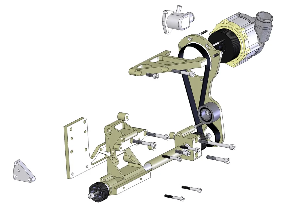

Is it this one ?
On on left in bottom pic
