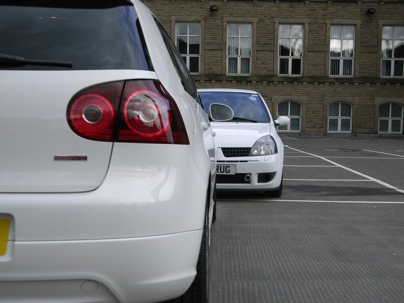

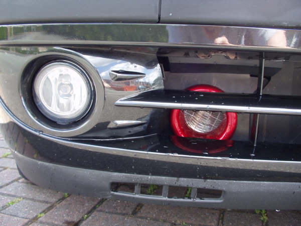

  VRS
my 182:
my old 1.2:
  b/g 182, meg tourer
you will find lots on here if you do a search. it will give you lots of ideas in most colours

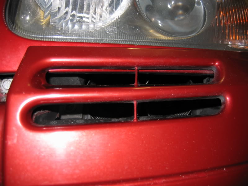

Not got a pic but isnt there a slit unfer the front lights on the Ph1s cant remeber if my old one had it or not :/

fuzzy i shall find/get a picture of mine,only place i could find
this is a pic with the bumper off
you can see in the middle i have made a cut out and my caf then went to that

is it too hard to scroll upand look at his post? He has it under the headlamp. Fog light is too low but everyone on this site puts it there so u might as well do the same
o yeh sorry blonde moment!!!
yeh im looking for a place on my 1.6 non sport. not got any vent in my bumper like that. is a smart place to put it though.

loving the white and black looks sick, my car will be black and white hehe best 2 colours any more pics of trumpets in fogs?
i would like to know how the cold air feed bends from the lower grill up tp the air box, it looks really tight!
there is a sharpish bend in the feed but the airflows up there quite nicely, my original test was with a hairdryer when i fitted mine lol, when i had the car on the rollers you could feel the air from the fan blowing through to the maxogen.
i dont have mine connected to the maxogen though, just pointing to the airspace behind the headlight whee the maxogen sits, i wouldnt fancy connecting it straight to the maxogen with the feed being so low and the car being lowered though just in case it slurps up a big puddle lol

mines held on by a jubilee clip behind the grill, clamps it in place and it hasnt budged for the last 2 years so its all good :D

What duct did you use Andy, any pics of it in behind the headlight?
i used pipercross ducting, the same stuff you get with the vipers, basically cos its flexible but strong with the metal ribs it has in it, in order to get the correct length i emailed pipercross and pretended i had a viper and the ducting supplied was too short to fit with the clio 182 so they sent me an extra long piece foc :approve:
