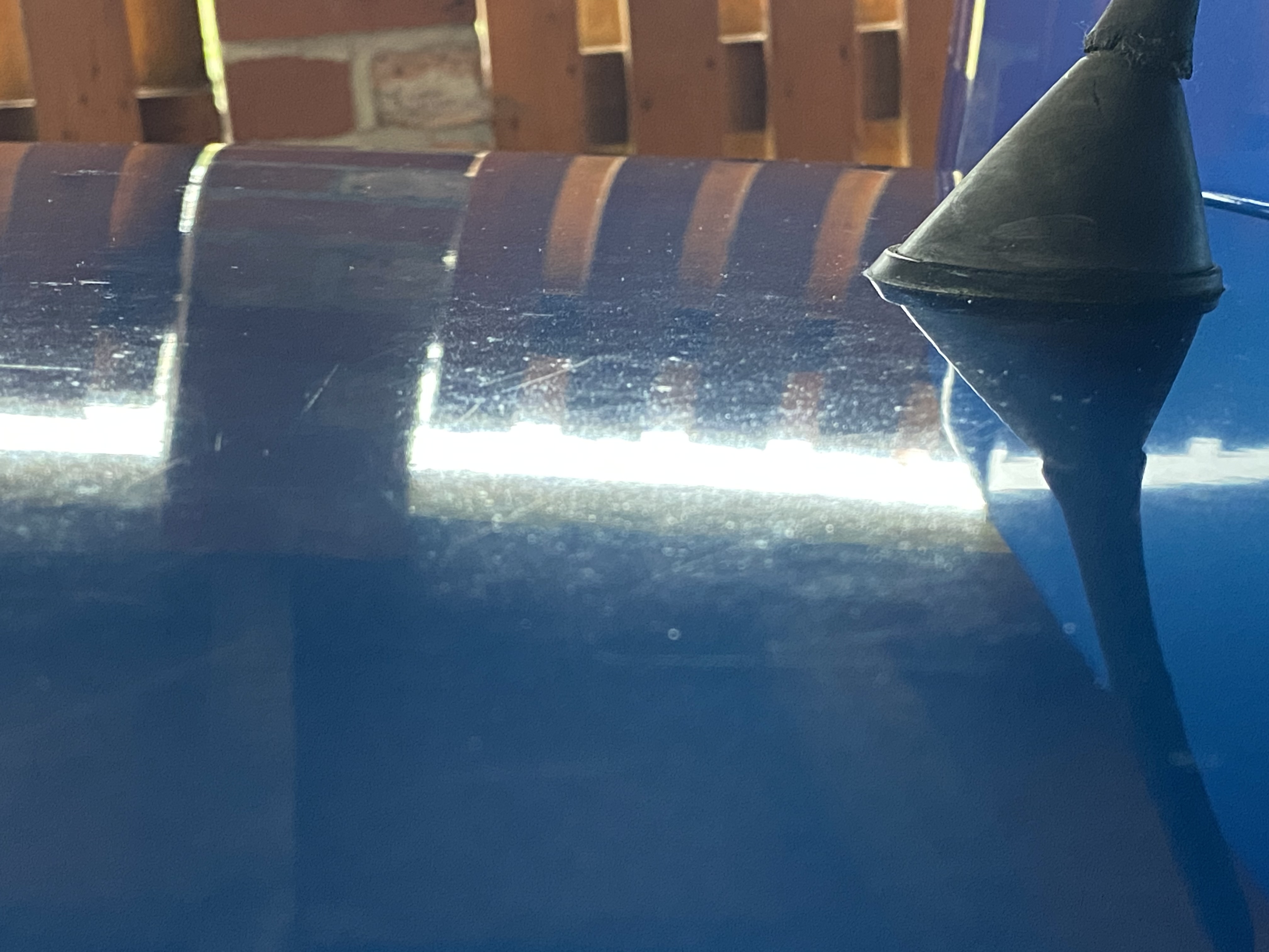

My 172 Cup is in need of a damn good machine polish after I washed it and tried to get the roof decent. Spoiler alert: I couldn't! The rest of the car also needs doing, so after it's had its belts and service and bits the paintwork will be tackled. I'm not one for polishing my car every week but it certainly needs a big hit to get it looking better. Have a look at the photo I posted here...that is after I used a paint restorer and polish. It looks sh1te!
Firstly, would it be better to let a pro have a go and if so what do they charge?
Secondly, if I do it myself is this Halfords polisher any good? Like I said, I won't be polishing every week so it won't get much use.
And lastly, on the Cups what is the risk of going through the lacquer when trying to remove the scratches? There looks like a spot on the roof that has lacquer damage so a little concerned about that.

Pro proper job you're probably looking at £600+ tbh looks fairly marked up so will probably need a good polish. Lots of good polishers out there.
I personally just use my pxe80 with carpro essence and lake country orange pads which could be worth a try it'll certainly make it look better and I've been pretty amazed by the results for such a simple combo. You'd probably want a proper polisher though if you want to go at the whole car in 1 hit.

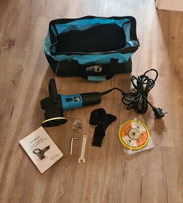

@ex-Chinese Dave would a used one of these be any good mate?

I bought this polisher from a member on here and need some pads for it What do you recommend (type and quantity) given that my roof is a bit crap (see pics above) and the rest of the car needs a good going over?
Also, I bought some Auto Glym paint renovator and Super Resin polish when I first bought the car. I don't want to be spending a fortune on polish and as I already have these two products but how do you think they will go on with the polisher?
