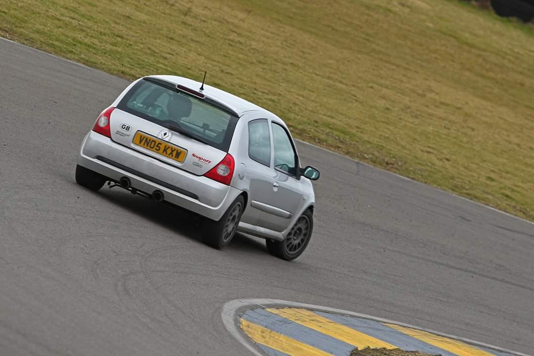

Wish it showed it without to really show the full extent of movement. Crazy how an ARB, running along the similar shape and being much thinner can stiffen it up so much.
JamesBryan
I did a test at Anglesey last year with the whiteline disconnected on one side and you can clearly see from this picture how much deflection there is between the bar and it's mounting link.
