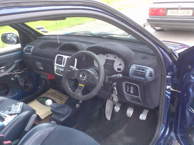

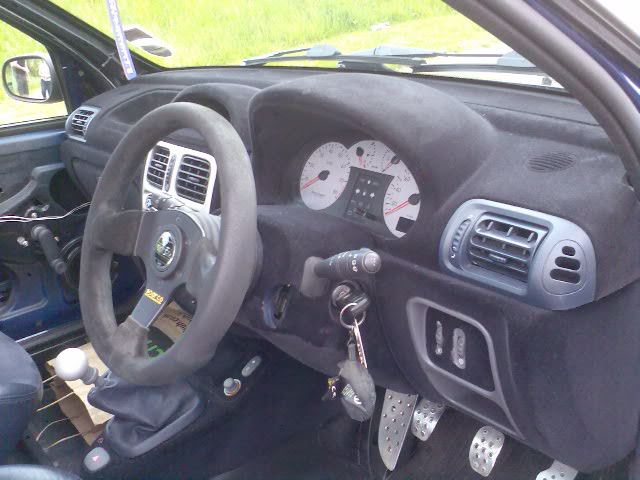

^Grays dash which has also graced the pages of Retro Cars and PVW magazines :cool:
