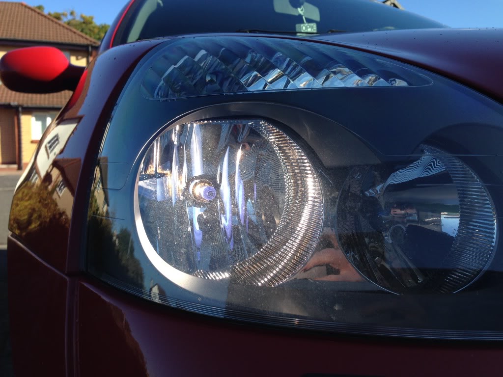

Will these pass an mot?
Crybert
  Cup 172
They are sort of white bulbs. Bought the car with them but not sure if they will go through an mot. I also need side light bulbs. What size should I be looking at?
  Changes to often
think they should be ok, my old clio i had, had them 'off road use only' bulbs in, the blue ones lol, and the mot tester just put them down as an advisory they the lights had a blue tint.
GrahamS
  335d
as long as they are the correct colouration and do not dazzle they will pass.
Blue led side lights for example are a fail.
Side lights are 501
