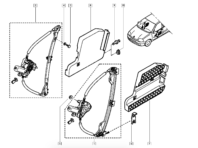

Hi, my window has fallen off its runner but still goes down by hand then back up with the buttons. Think it's just the little plastic bit that holds it together does anybody have a part number or anything for it?

I bought the plastic kit off ebay. when I swapped the full regulator over I snapped the little clip. I'm not sure on parts numbers though I'm afraid.

Give renparts a call they supply all you need
