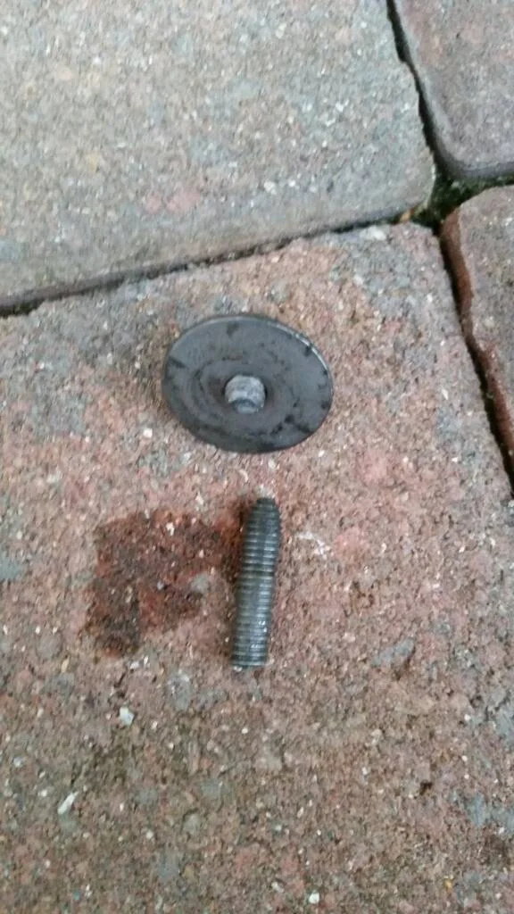

So I attempted this today, got everything off of the car, undid and tightened all the bolts under the scuttle panel AND one of the bolts snapped!
But of course it's past 7pm on a Saturday and everywhere is closed! So I've had to put the car back together minus the wipers and go to B&Q first thing tomorrow (well 10am)! FML
