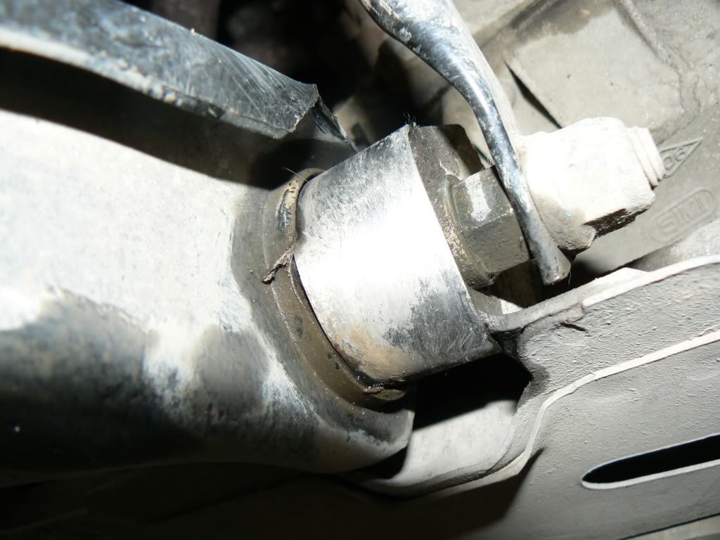

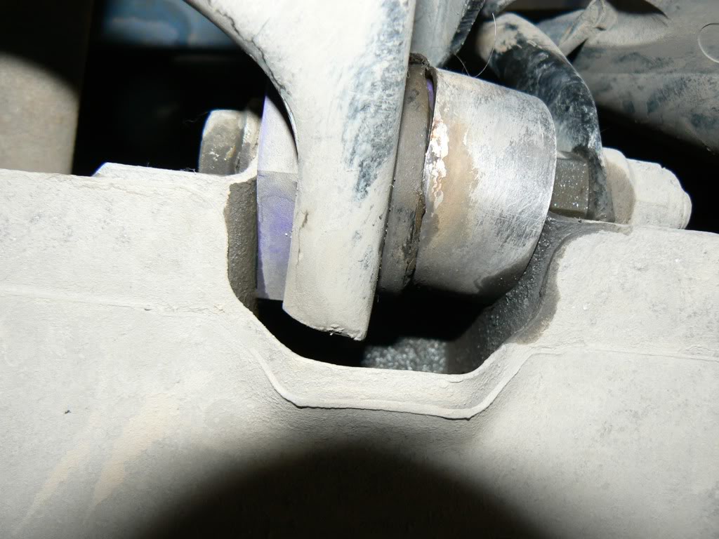

be careful with the wishbone bushes! they started to squeak and I thought "oh well I expected this" but it turned out that the outer sleeves on 2 bushes came out and were rubbing against the subframe mountings..
this lead to some damage to the mountings but I managed to make some other custom made sleeves and welded them to the arms. I suggest you do the same to prevent this nasty stuff from happening

I do have two pics with one of the bush that came out, but since I'm not at home right now I can't post the pic with the job done. you just have to make or order some other sleeves (or reposition them if things aren't as bad as in my case) and weld them on the arm in 5 or 6 spots as this will be enough to hold them in place. if you want as soon as I get back home I'll post up the pics with the welding done

as you can see this is pretty nasty stuff and it will damage your tracking geometry.
Good luck!

i got ya now dude the outer sleeve that sits around the bush slowly came out so just get them into position and tack them in :)

I have these bushes as well and the sleeves must be welded in place. Not just crappy spot welds as I used the first time. These spotwelds broke after some serious track abuse. So now I have 3x3cm TIG welds on each sleeve.
So do it propper the first time.
