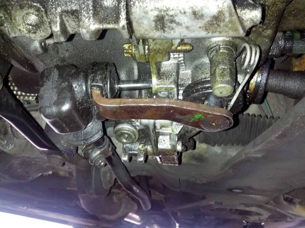

Well after a bit of fiddling under the care with the selector it will now go into 4th and 5th. I took a pic, does anything look a miss with the selector? The clutch seems to engage and disengage fine in 4th and 5th
  Clio Williams
It looks fine but a bit mucky ;). Try to select all gears by moving the selector arm with your hand. Can you select 5th, 4th but cannot 3rd? Can you push up the selector arm (preselect R, 1st and 2nd gears)? In which gears cannot you turn the selector arm?
  monaco 172
5th and 4th can be easily selected by hand or by the gear stick.
3Rd I would have though is just the opposite way from 4th but the selector just won't move that way at all.
I can't even move the selector up to even attempt 1 2 and r. It just feels like its hit something
  monaco 172
Well after taking off the linkage and tapping the selector with a hammer the box is working perfectly again...
Wtf!
Does this mean the selector inside the box is probably on its way out then?
  monaco 172
Done a fair few miles now and all seems well. No idea what was wrong there. Still got the annoying whine to try and find now. arrrg

I bet the linkage but underneath was nipped up and it moved position. After you took it apart and put it back together it works.
