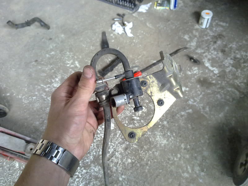

ive put the engine back in my 172 and have this left..... what is it? and where does it go?
thanks people!

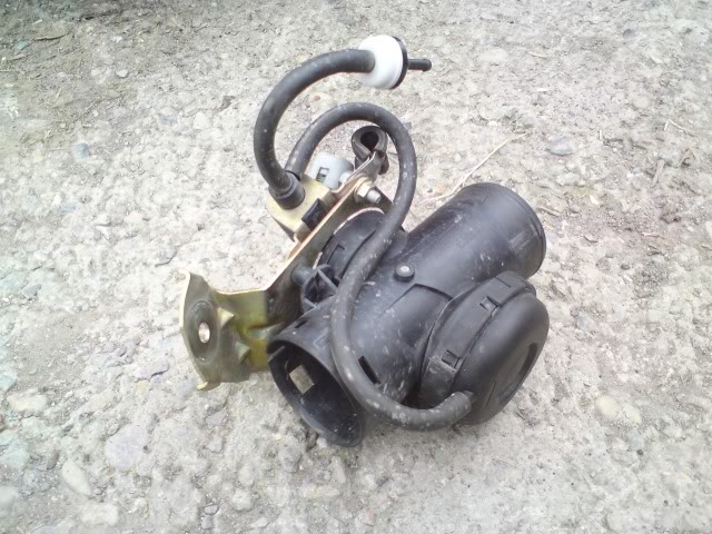

is that not something to do with the acoustic valve?
if so you can safely bin it.
yeah, it looks as though the plastic tube with the butterfly valve in it is missing?
so long as its vacuum take-off from the plenum's blocked, should be OK
ed. already said

lol at the rivet, plugging a vaccum point I imagine, would make sure you don't have an open vac point drawing air into the engine.
looks to be exactly that, is the white bit with barb a check valve? i.e. residual vacuum on one side?
