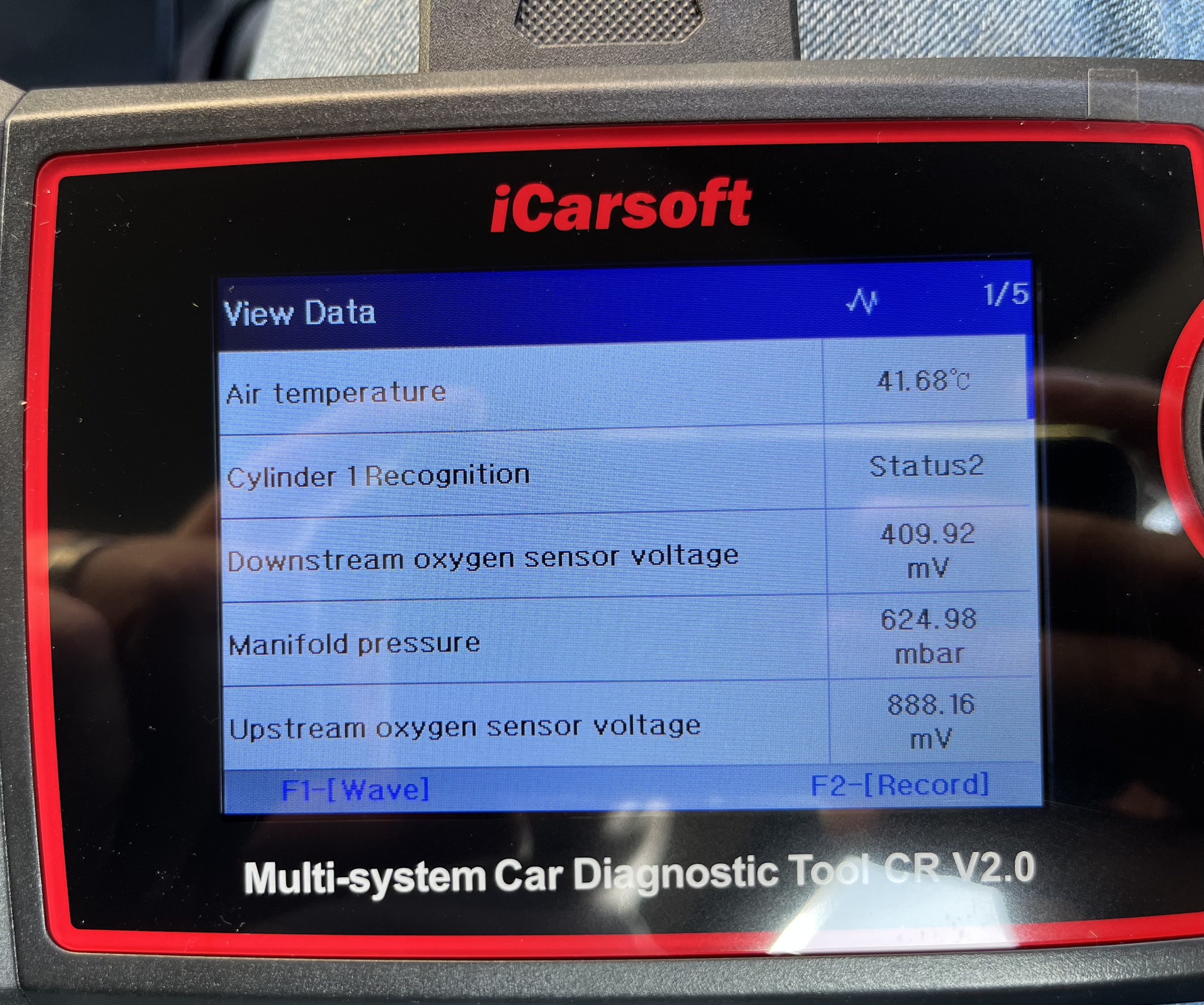

There are no warning lights or error codes but when idling, values are as follows:
manifold pressure is around 620mb at idle, and just over 1000mb with the engine off.
Upstream lambda oscillates between 19 and 890mv or so.
downstream lambda is pegged just over 400mv.
I’m figuring I have wasted my money on plugs, injectors, leads and coil and should have had the valve timing checked as the first stop… what do you think?

I have given in and booked it in with Chris @ Beaniesport next week to check the timing. Given the nature of the belt change, I’m pretty sure that will be the issue.

Hi, yes. My timing was indeed out by around 7 degrees. I got it rest at a specialist, and it is like a different car. Both in terms of idle and drivability. I have an after clip on my tidy up thread in the projects section If that helps.
Although doing a timing belt on these is a pain, access to CHECK the timing is actually not too bad. Some of the inlet needs to be removed, and a new pair of cam end caps will be needed. I think it took less than £10 in parts and about 1/2hr in labour for the specialist to check mine And tell me it needed done.
