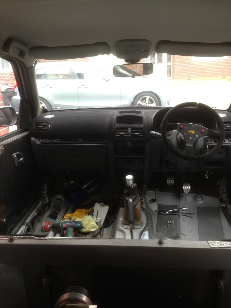

Door cards refitted.
lexan windows fitted now secured.
New dash top fitted ( flocked)

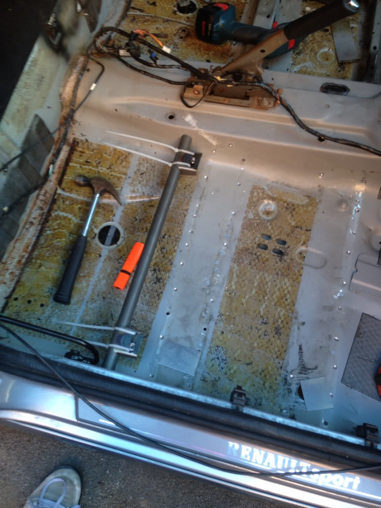

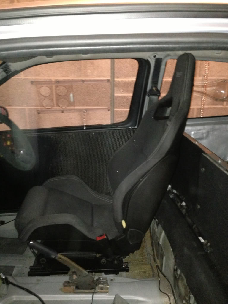

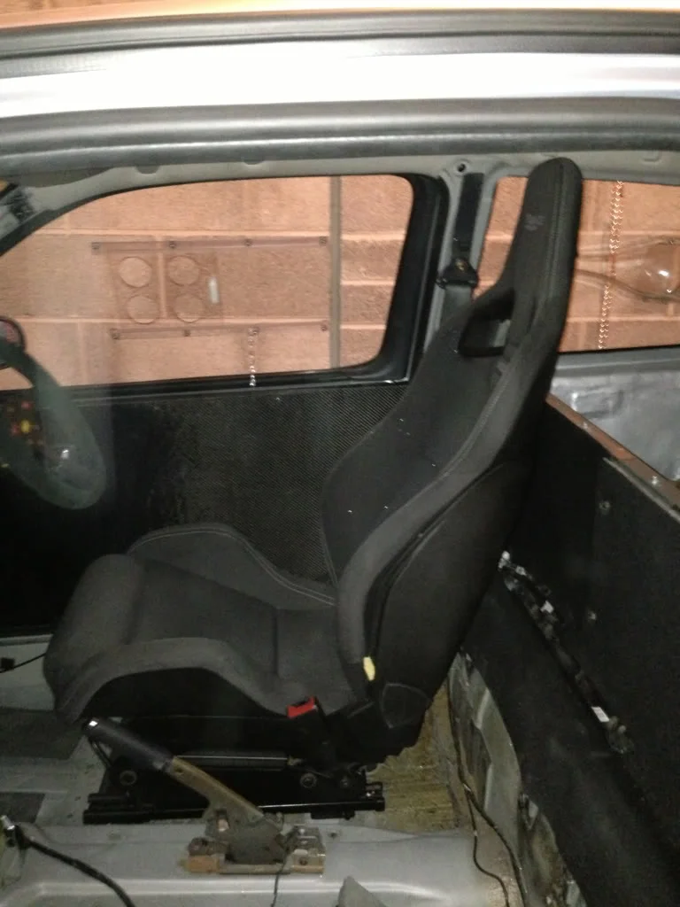

old seats removed.

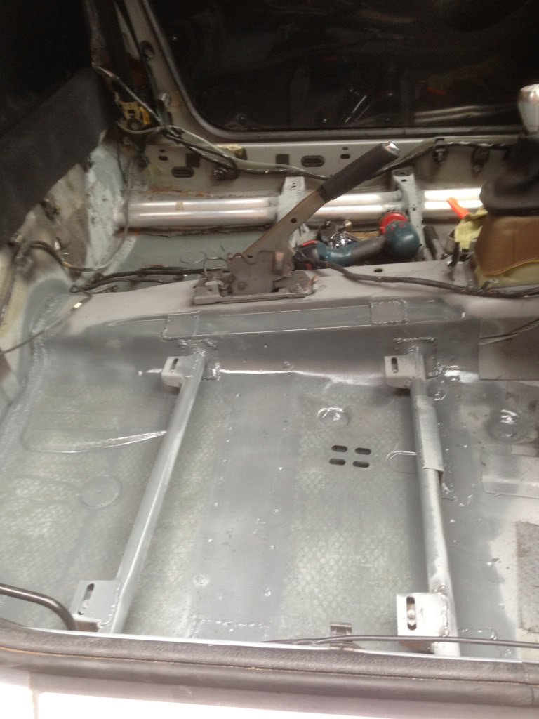

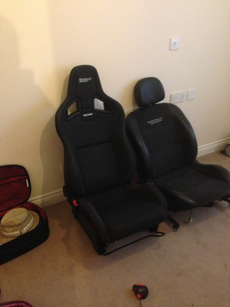

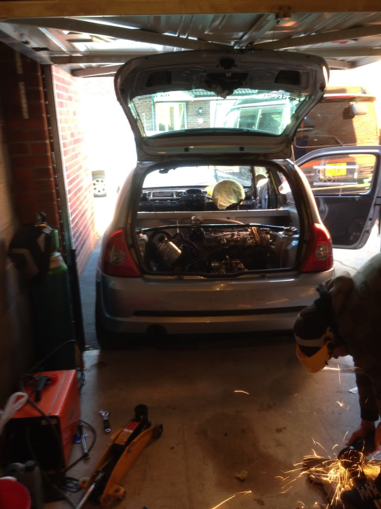

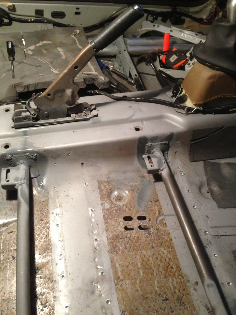

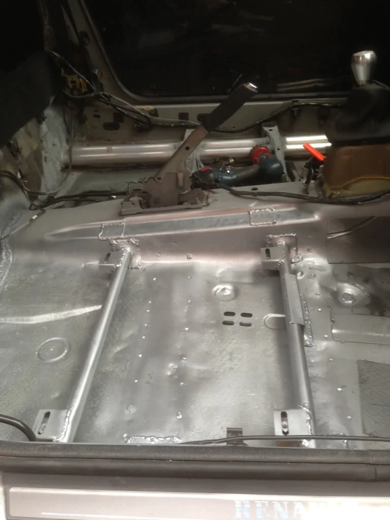

the recaro seats are glint to be a pain to fit.
going to have to weld in mounts for them as the recaro seats frame is very narrow and they have to sit as low as possible !
wish I bought them from capital instead of using 197 ones. A lot of hassle.
